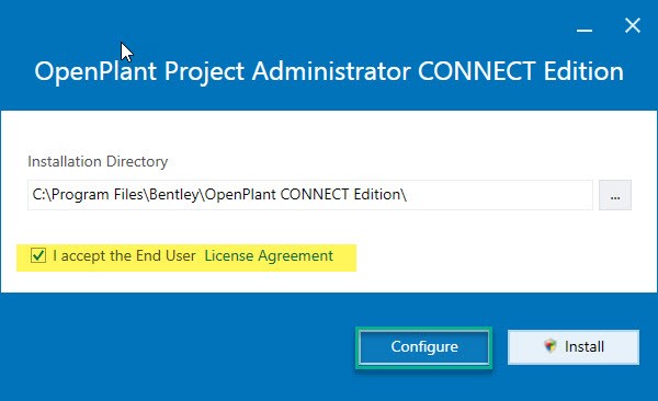

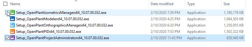

  1. Run the Setup file for OpenPlant Project Administrator.
  2. This opens the setup dialog, select Configure.

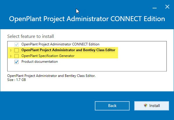

  3. Feature selection dialog will open.

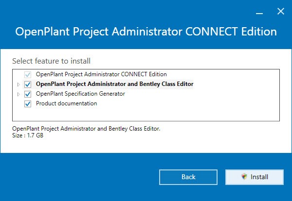

  4. Enable the features OpenPlant Project Administrator and Bentley Class Editor and OpenPlant Specification Generator.

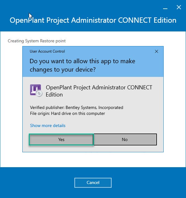

  5. Select Install and Yes.

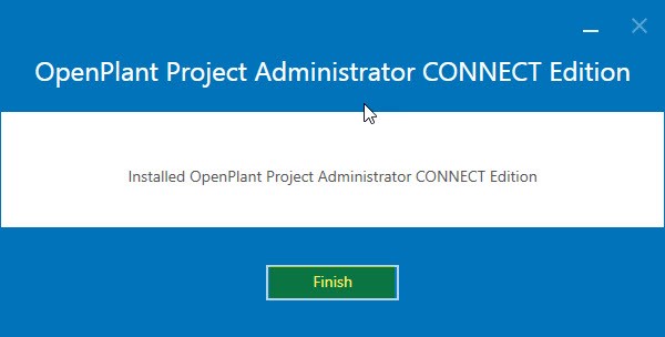

  6. This will install OpenPlant Project Administrator CONNECT Edition and we can see Class Editor and Specification Generator installed.
  7. We can see that Class Editor and Specification Generator is installed with OpenPlant Project Administrator.
