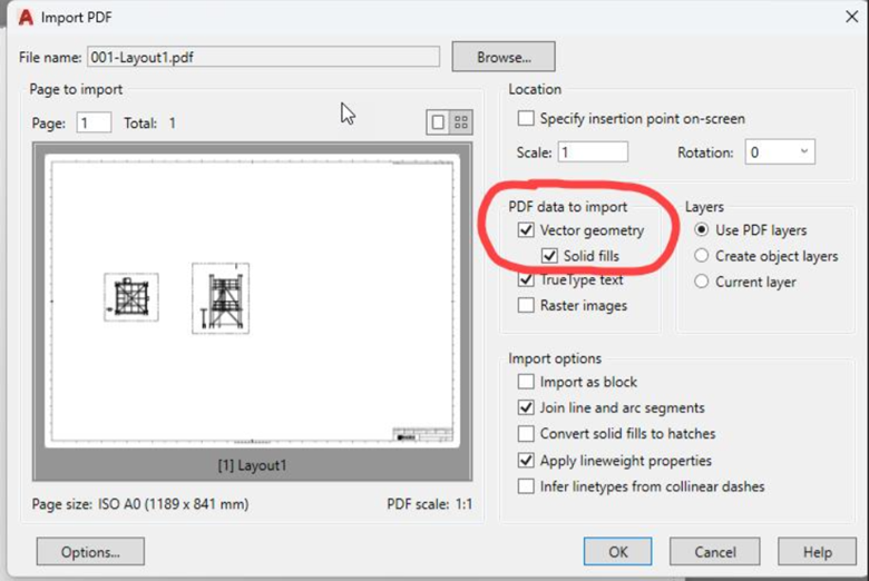

2. Create a new drawing. Run the PDFIMPORT command to import the PDF.
3. Select the following options.
4. A message will appear then select to import the PDF file as AutoCAD geometry.

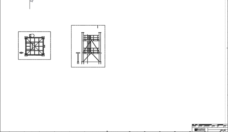

5. This will be the result.
