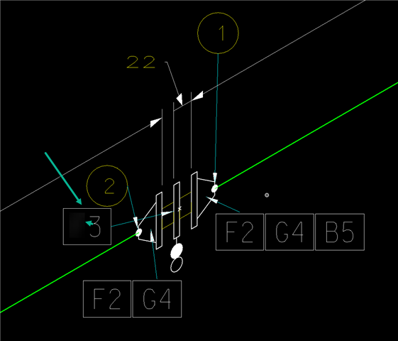

In OpenPlant Isometrics Manager, user wants to remove PartID prefix for spectacle blind. Currently in generated isometrics spectacle blinds shows prefix as shown below.
Here requirement is to remove prefix “F” & only to show number for spectacle blind.
