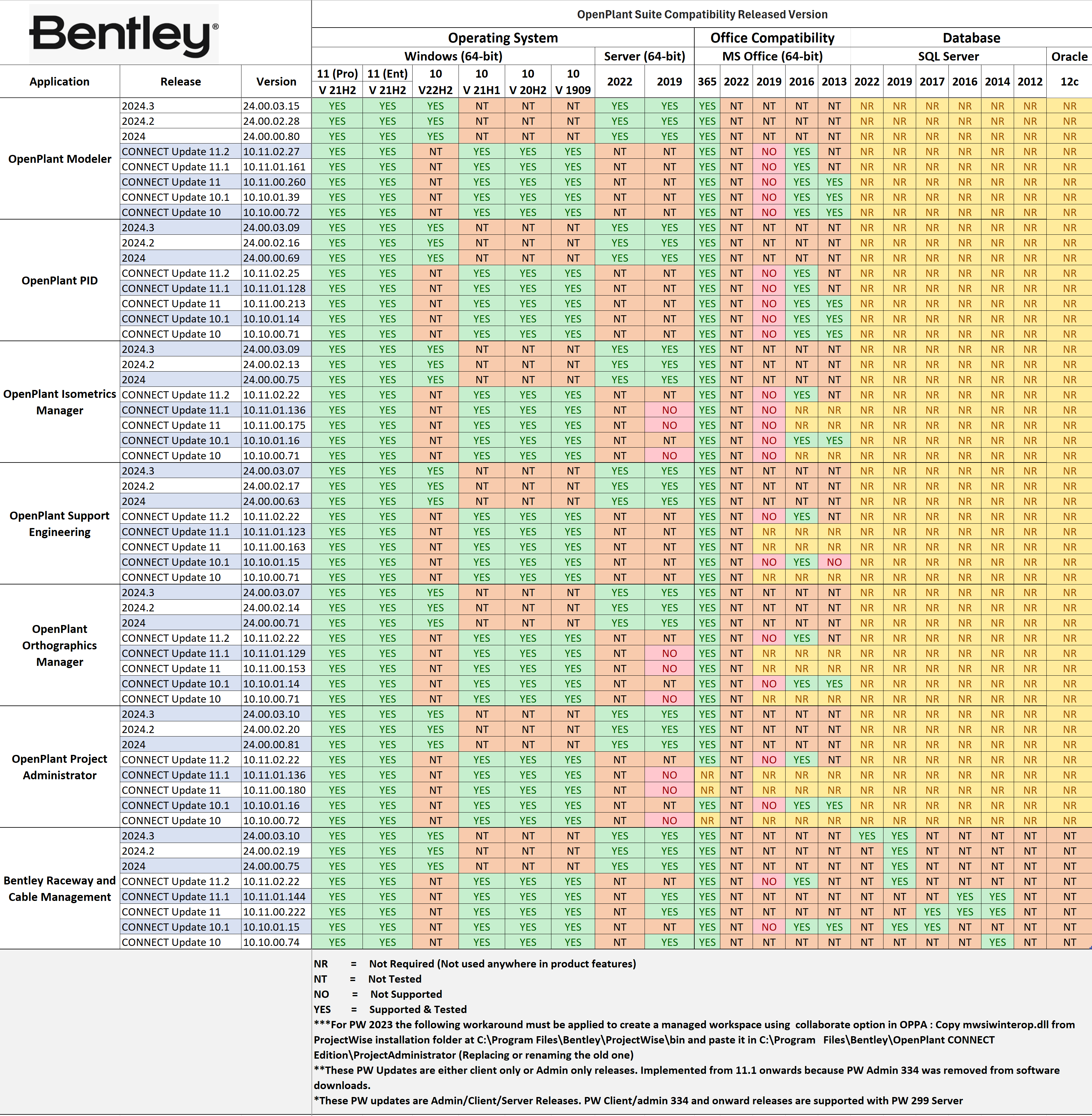

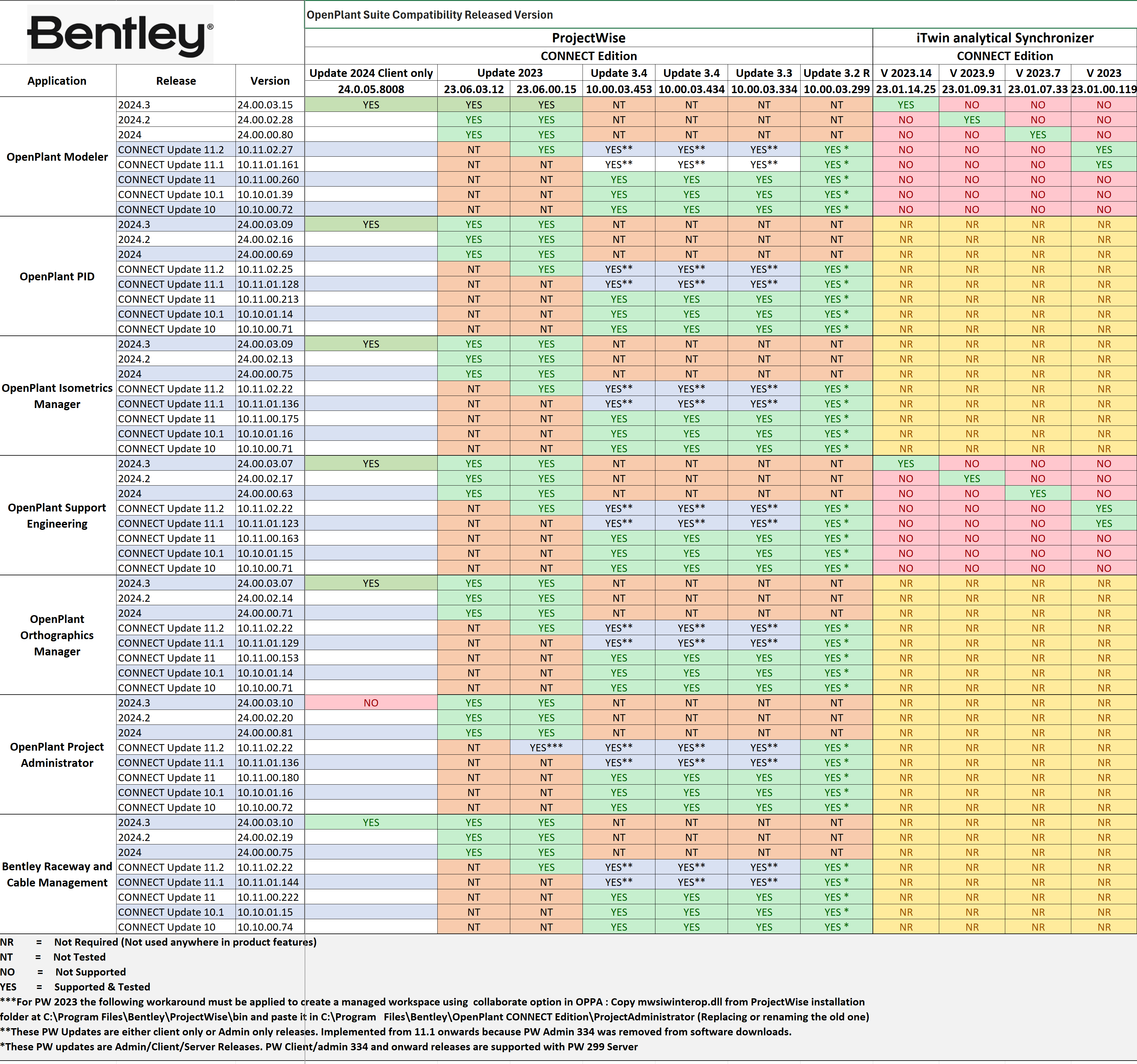

OpenPlant Product Compatibility
Here compatibility across different release versions of OpenPlant Product with Operating Systems, ProjectWise and various Database types is presented. The compatibility matrixes are available in pdf format thus could be downloaded.
Follow the link below for instant access to the required matrix:
OpenPlant CONNECT Edition Suite Compatibility

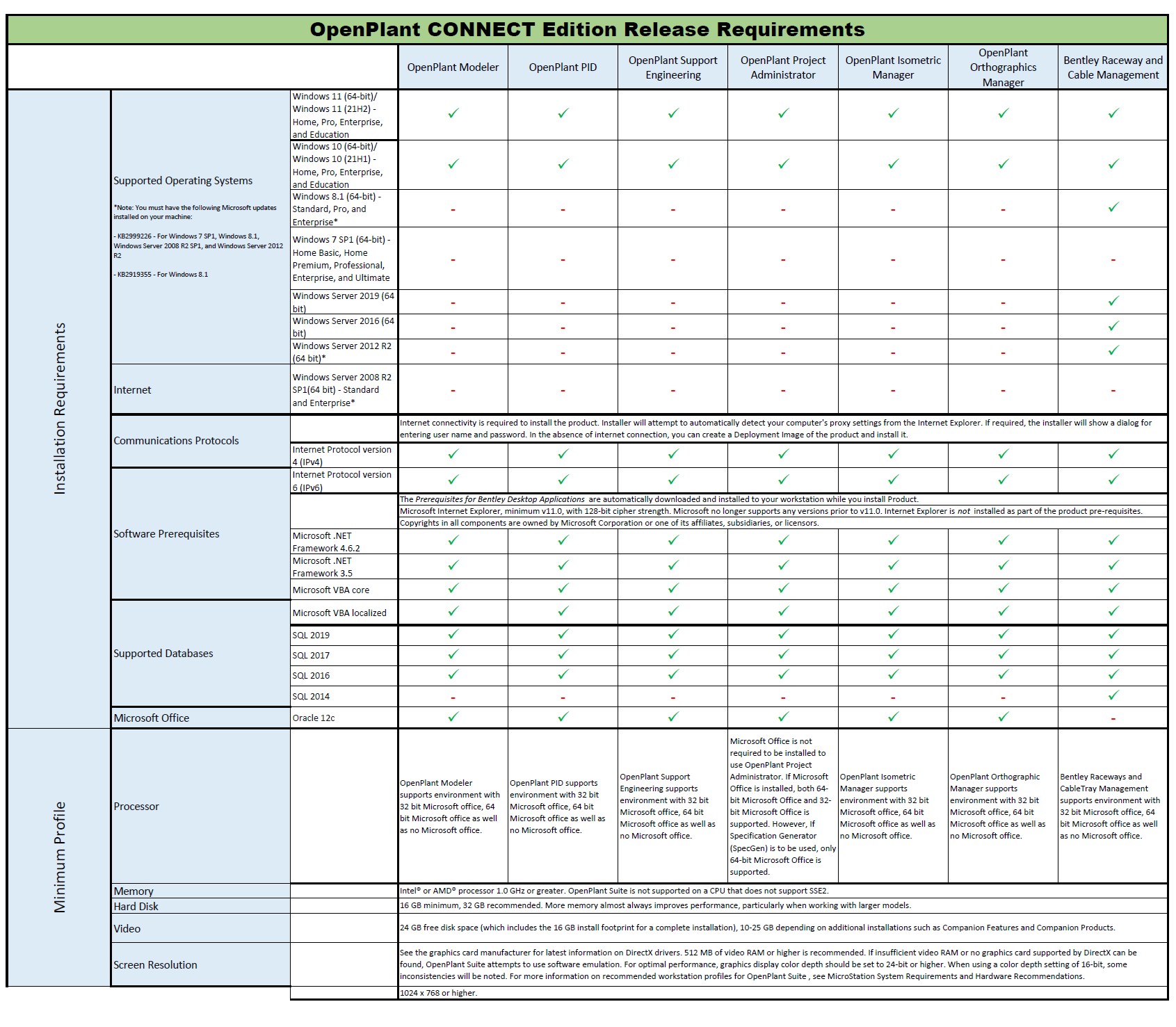

OpenPlant CONNECT Edition Release Requirements
Release Requirements - CE
