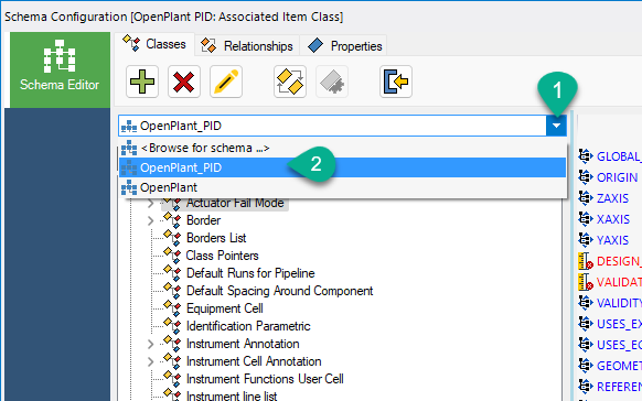

- Click on the Settings Ribbon and select Schema Editor. Refer to the sequential steps as shown below.
- From the Schema Configuration dialog, ensure you select OpenPlant_PID as shown in the image below.
Note: To include any schema changes for a PlantSight enabled WorkSpace/WorkSet, we need to include changes in both the OpenPlant as well as OpenPlant PID schemas.

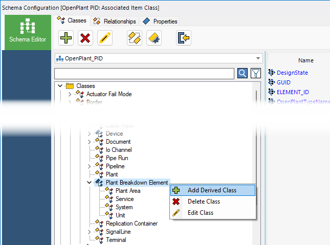

- Search for Plant Breakdown Element class. Right mouse click on it and select Add Derived Class as shown below.
- Enter desired class name, i.e. TRACK_NUMBER as shown below. Click on OK once done.
- A dialog window will show, select Yes. This will also be added in the OpenPlant schema.

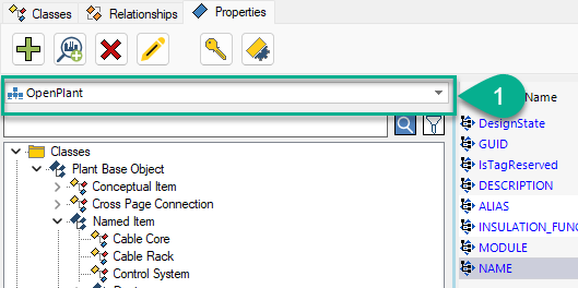

- From Schema Configuration, select the schema as OpenPlant as shown below.
- Select the NAME property and click on Mark Selected Property as Business Key option as shown below.
- Click on Save to save all the schema changes. Refer to the image shown below.

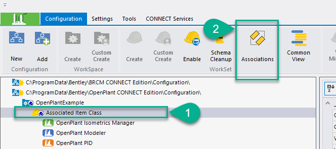

- From OpenPlant Project Administrator, select the WorkSet, and from the Configuration tab, click on Associations as shown below:
- From Schema Configuration, select Track Number, and click on the blue arrow to add in our Plant Breakdown Structure.
