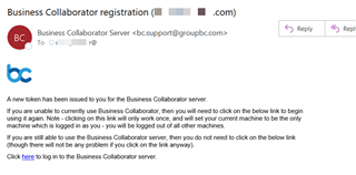

You will have received an email like the one shown in Figure 1 because someone issued documents to you from a BCDE server where you do not have a username and password.
Figure 1
To access the documents which were issued to you:

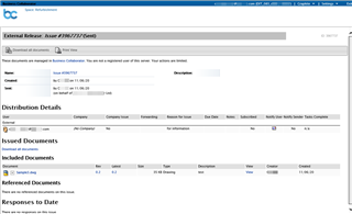

   1.   Click the green View (or Respond) button in the Issue Notification email – see Figure 1.
   2.   This will save a token on your device and open a browser window showing you the documents which have been issued to you
Figure 2
You should save this email so that you can return to the documents which have been issued to you later (This link provides your only access to these documents).

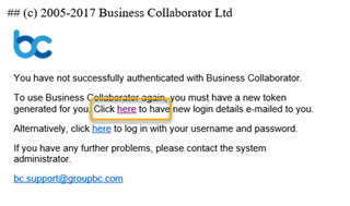

If the token is missing or is not valid, you will not be able to authenticate with BC. Instead, when you click on the green View (or Respond) button in the Issue Notification email, you will see the message shown in Figure 3.
  Figure 3
   1.   To resolve this, click the 'here' in “Click here to have new login details e-mailed to you” as indicated.

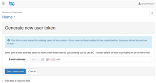

   2.   On the resulting page Enter your email address and click Send. (This must be the email address which the issue was sent to. The address the issue was sent to is shown in the 'To:' section at the top of the Issue notification email, above the Company logo).
Figure 4

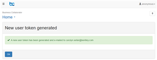

   3.   'New token generated' page will be displayed*.
Figure 5
   4.   You should not click OK (Doing so would take you to the server front page but you do not have a username and  password for the BCDE server so could not log in in from that page.)
