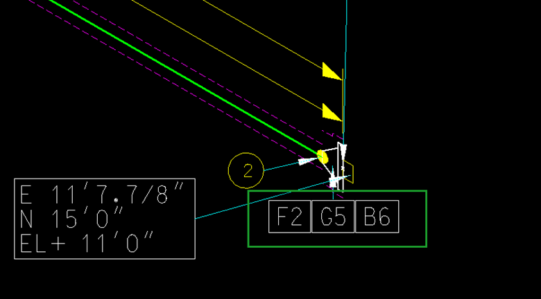

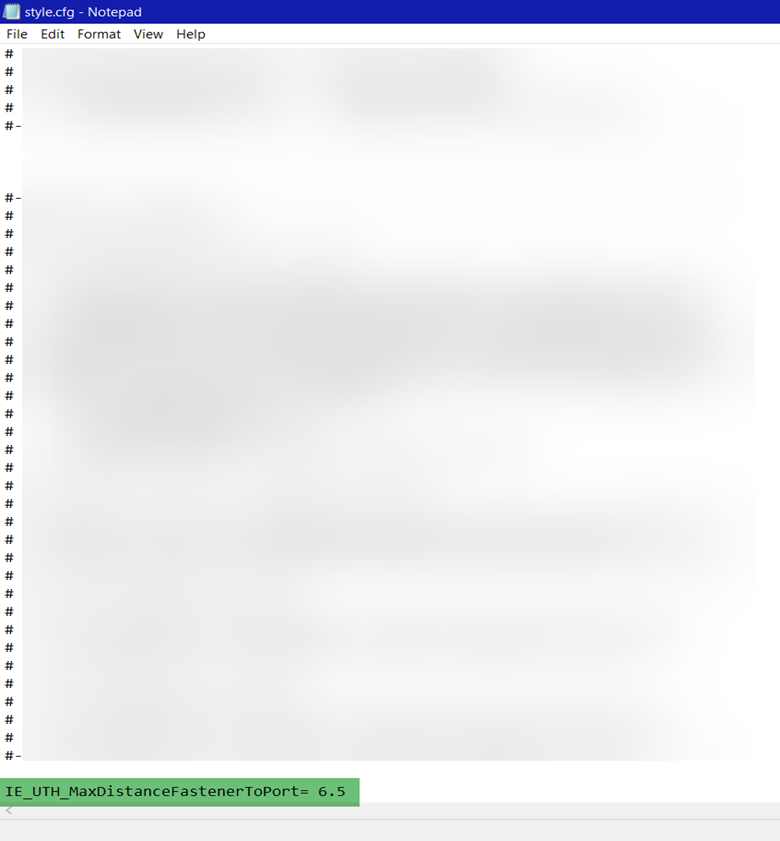

The bolt label in generated isometrics is missing due to the error message appearing in isometrics configuration box.
