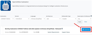

1.登录官网:https://connect.bentley.com/ ,进入Software Downloads。
2.在Product Line中选择Electrical and instrumentation分类,点击Apply。
3.拖拉左侧滑块,找到OpenUtilities Substation软件,点击Get Software
4.点击Download,下载在线安装软件

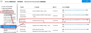

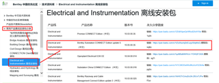

5.Bentley中国有限社区官网https://communities.bentley.com/communities/other_communities/chinafirst/w/chinawiki/39547/electrical-and-instrumentation
Substation CE离线安装包下载:
OpenPlant Electrical CCK CE离线安装包下载:
