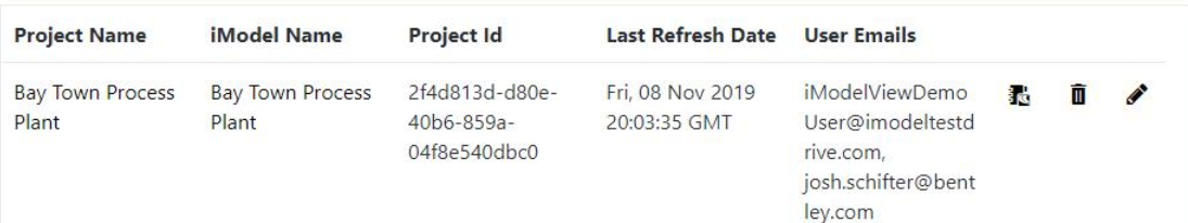

To start with, we need a project and iModel name. I recently uploaded one using the registration dashboard:
Let’s see what this could look like.
It respects your cases and spaces :)
This also makes switching to new iModels much easier!

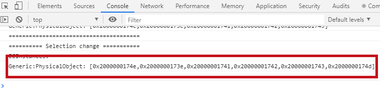

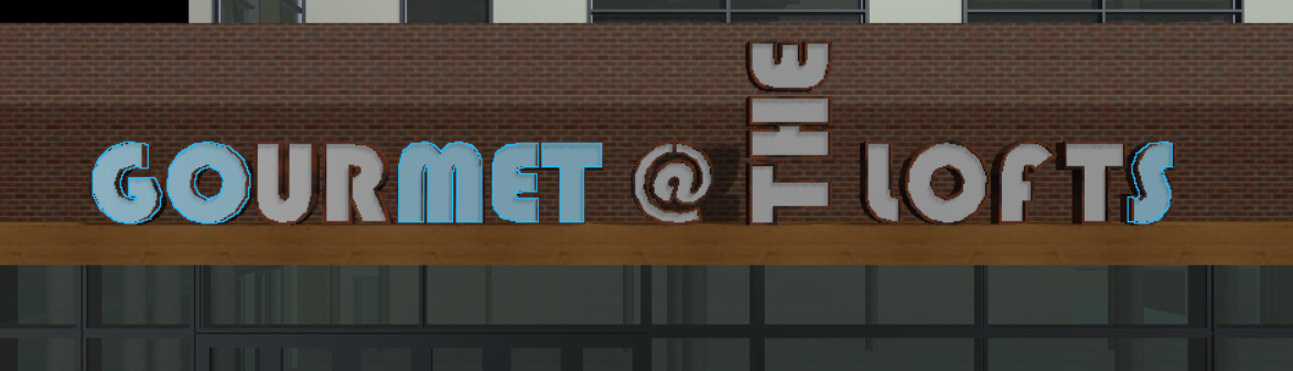

We need something to uniquely identify the elements to zoom into. Lucky for us, the simple-viewer-app conveniently logs the IDs of elements that are selected in the viewport.
Let’s select some letters as an example:
Hit “F12” to open up the console.

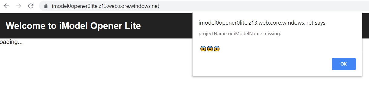

Using these IDs…I can construct this shareable link that hands the context over to you. Similarly, you can pass in any combination of information you need as URL parameters. Here are some more dairy-free examples:
In the last one above, make sure to pass in your project and iModel name. Else it freaks out.
