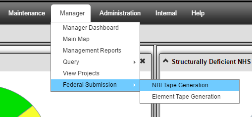

To create the data necessary for the federal submission, go to Manager > Federal Submission > NBI Tape Generation

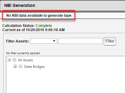

Nothing happened? No download? Look in the upper left corner for messages:
1) No NBI data available to generate tape
When no assets are selected, no assets will appear in the submittal data.
Solution: RESET the data, filter the asset tree to the assets you want to include, select the assets, GENERATE NBI SUBMITTAL.

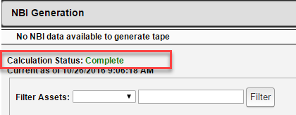

2) Calculation Status: Updating
When the calculation status indicates Updating, the data is being updated between asset values and available federal submittal data.
Solution: Grab a cup of coffee.  Depending on the number of assets updating, system updates run approximately every 30 minutes.
When the calculation status = Complete, Generate NBI Tape.
