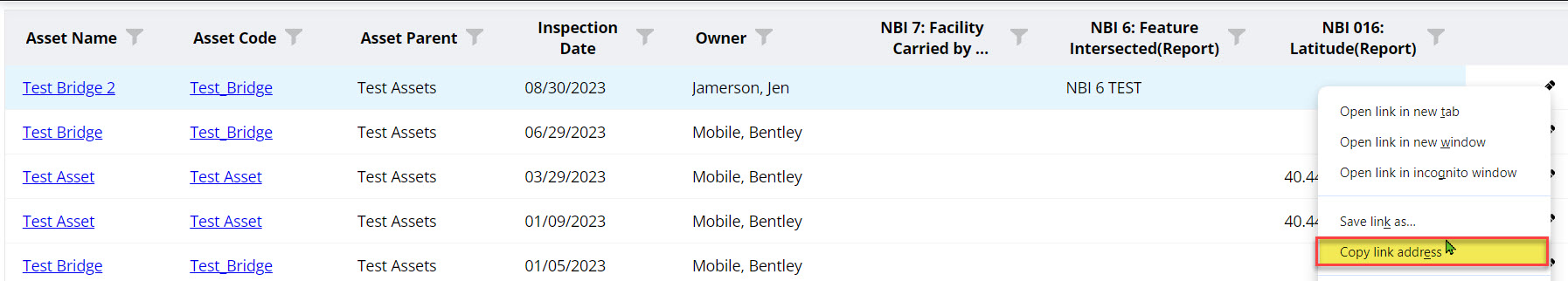

This is to get around the issue of the “view report form view” option giving an unexpected error so you can’t edit the report values.
Steps to resolve
- In the Report Filter, query the report you can’t open. Right click the pencil icon and select Copy Link Address from the menu that pops up
In this example, the link address is
https://cots-it-demo.bentley.com/inspection.aspx?id=85941&type=1
Make a note of the number in the “id = xxxx” part of the URL, highlighted above. This is the ID of the report we want to view.
