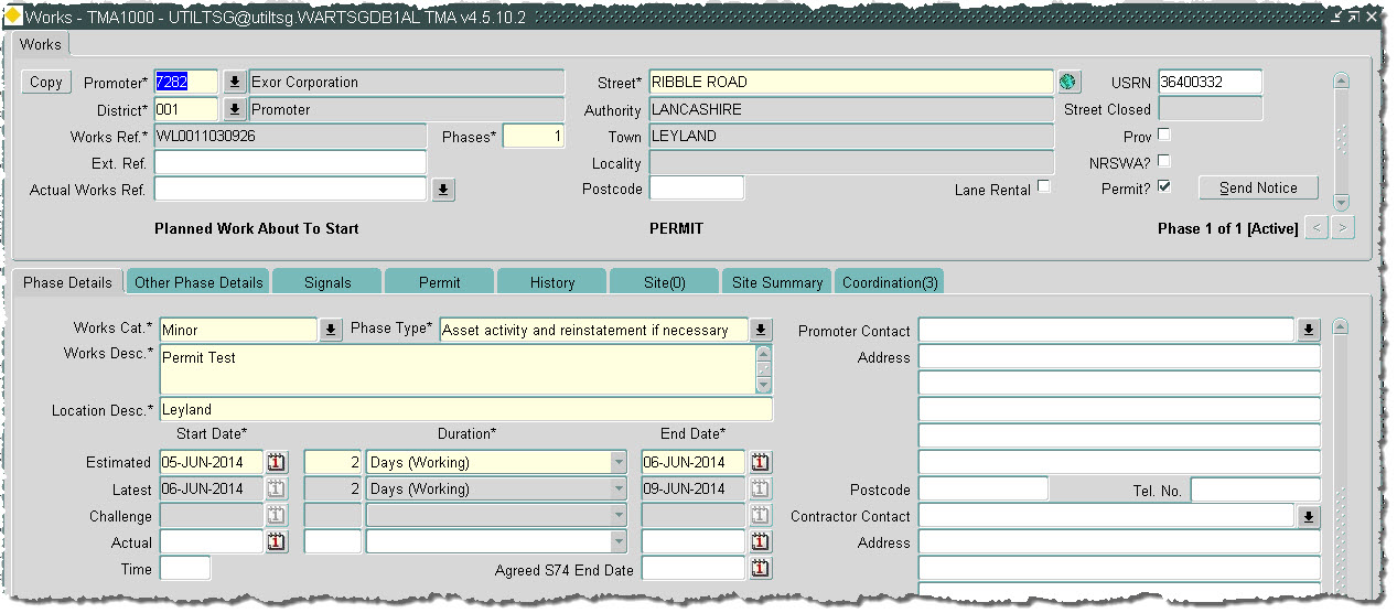

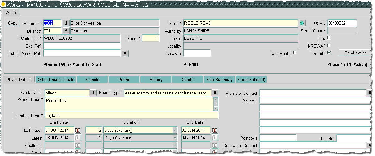

Example 1 - Category 4 street (not traffic sensitive) and works starting on a non-working day

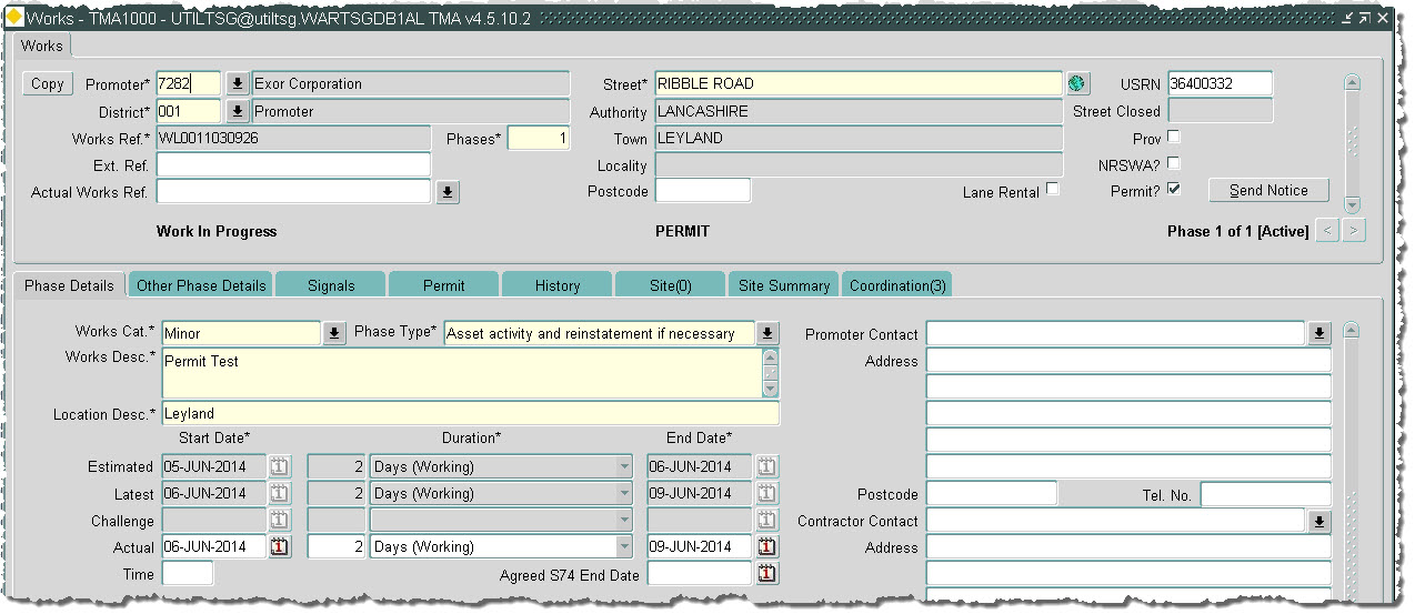

In this example we have used a street which allows the start date to slip and this is highlighted in the Latest Date fields once the application has been issued. As the start date can slip in this scenario, the reasonable period is calculated by the number of working days, predominately for section 74 purposes as per the CoP.

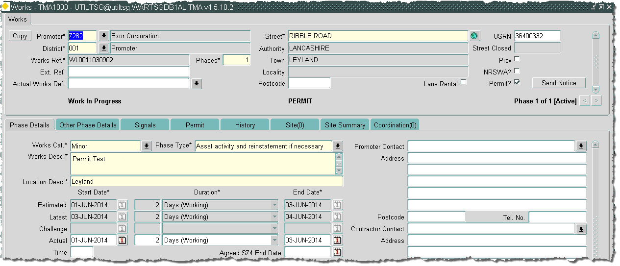

Next we need to send an actual start notice. To do this we enter the Actual Start Date and the application then automatically populates the ‘suggested’ Actual End Date field in anticipation of the Works Stop notice by looking at:

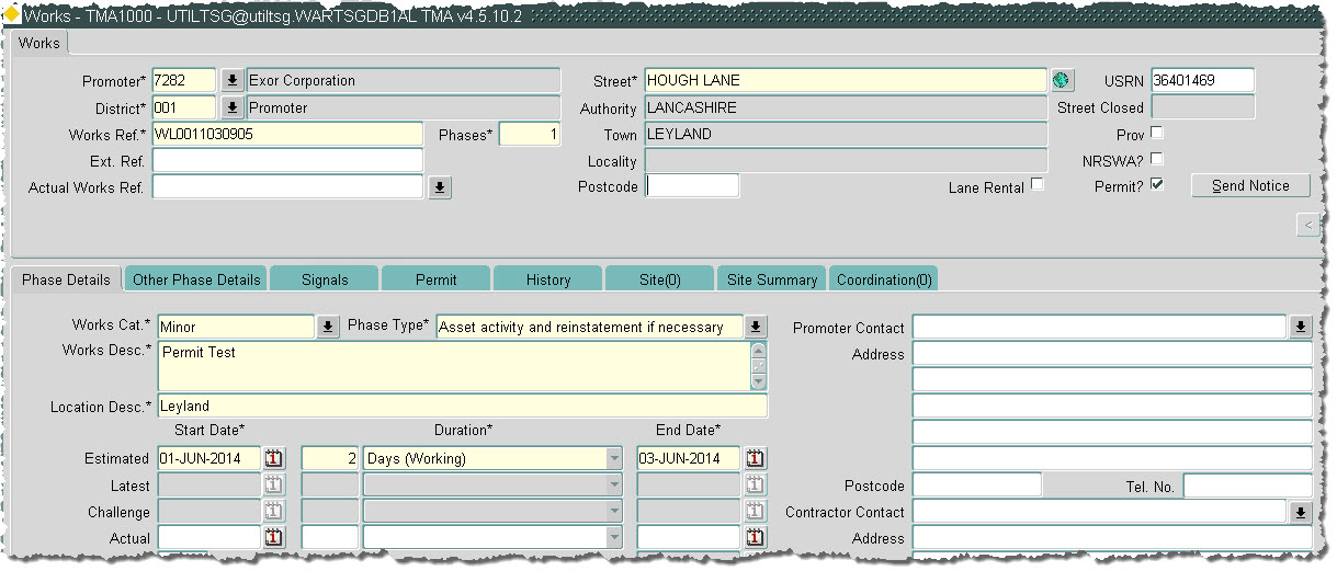

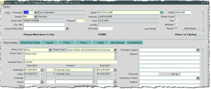

Here we have used a street which does not allow the start date to slip, which is then reflected in the Latest Date fields once the permit application has been issued. As the start date cannot slip in this scenario, as per the CoP for Permits the reasonable period is calculated by the number of calendar days between the working dates originally applied for.
In the screenshot below we have entered the working dates but have not yet issued the application (no phase status is shown):
In this scenario once the permit application is issued, the software updates the duration type to calendar days and populates the latest dates to reflect the fixed permit period:

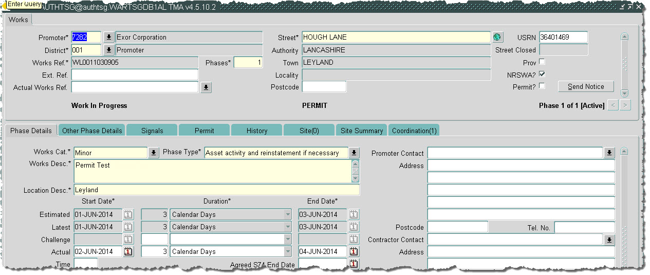

Next we want to start the works and send an actual start notice. If we started on the 1st as planned, the suggested Actual End Date would reflect the Estimated End Date as usual. However not all works start on the planned start date, so in this example to show you what happens we will start late on the 2nd. It is still ok to start the works late as we are still working within the period applied for, but as this permit has a fixed period, the Actual End Date must be the Estimated End Date unless a variation is applied for separately. This fixed end date is reflected in the suggested Actual End Date field once the Actual Start Date is populated:

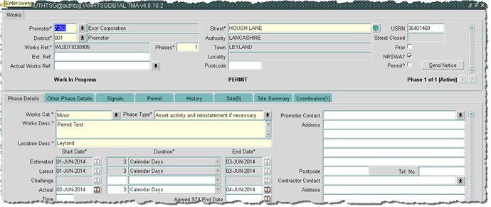

Authority System:
On authority systems where notices are received, it was decided that in this fixed permit period scenario the application should behave slightly differently and retain the original duration when calculating the suggested Actual End Date. The application does this as it expects the works promoter still needs the same number of days to complete the works and so it is very likely the promoter will apply for a variation to extend the permit period.

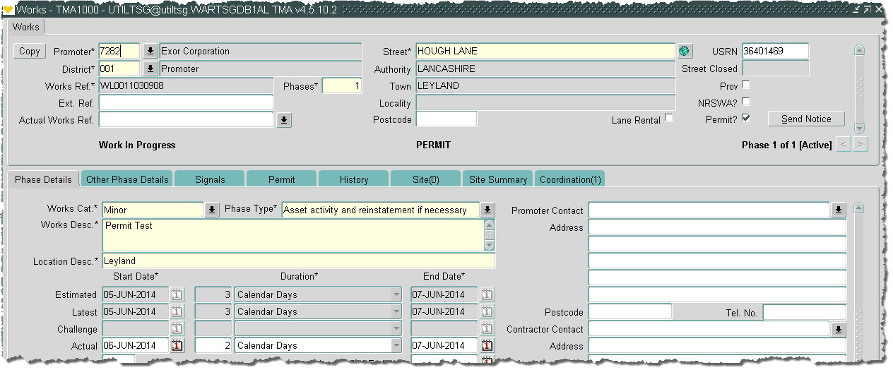

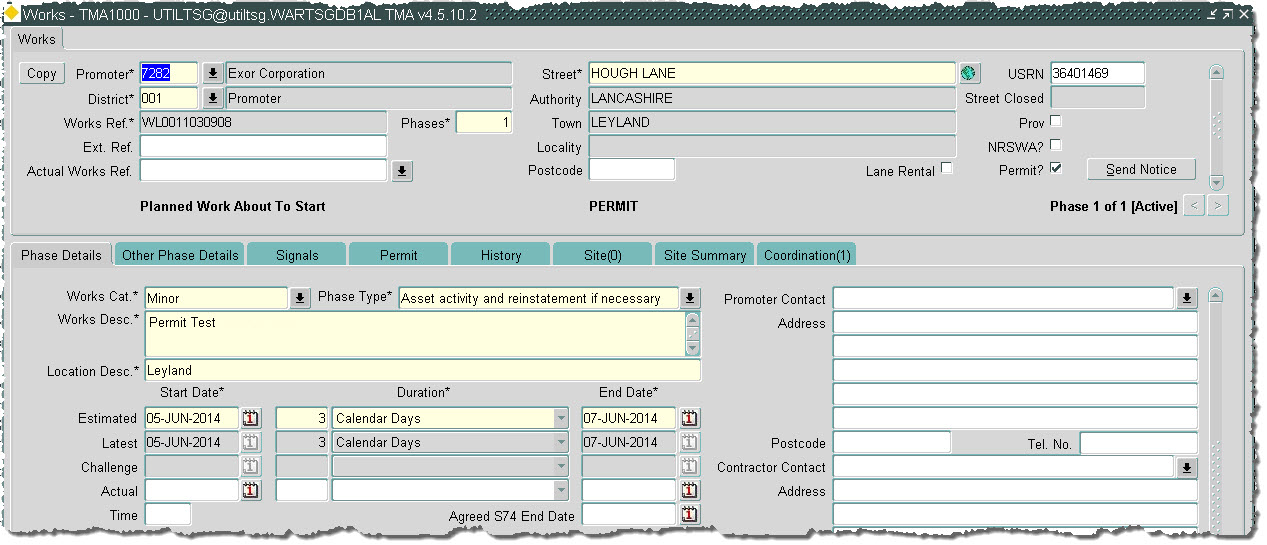

Example 3 – A traffic sensitive street and works finish on a non-working day
This is similar to example 2 but this time we will use different dates to start on a working day and end on a non-working day. In this example we start the works a day later than the estimated start date, but as it is a fixed date permit, the suggested Actual End Date remains the same. The application is able to do this because the duration is being calculated in Calendar Days. If the duration type was set to Days (working), the suggested Actual End Date would be calculated as the 6th of June – see example 4.

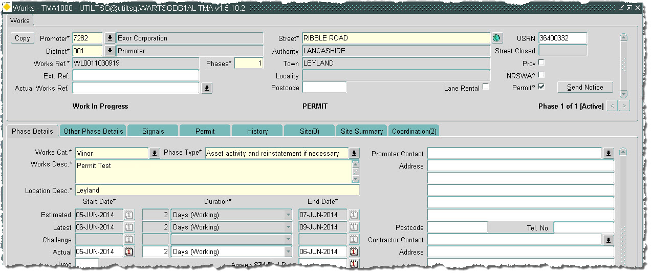

Example 4 - Category 4 street which is not traffic sensitive and works finish on a non-working day
This is similar to example 1 but this time the works are planned to start on a working day and end on a non-working day. Once we populate the Actual Start Date field to send an actual start notice, the application calculates the suggested Actual End Date using the duration between the estimated dates. As the duration type was set to 2 Days (working) and the Actual Start Date was the Thursday the 5th of June, the suggested Actual End Date is calculated to be Friday the 6th of June. This hasn’t reduced your permit by a day, it has simply calculated the suggested Actual End Date using the Actual Start Date, estimated duration and duration type entered. In this example you could still work on the 7th of June if required, but you will need to update the suggested Actual End Date before sending a Works Stop notice.
