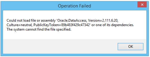

Cannot connect to Exor database from Exor Mapcapture Geospatial Administrator
 Product(s):Exor MapCapture
 Version(s):08.11.09.113
 Environment:VM,Windows 8
 Area:General
 Subarea:N\A
I am trying to configure Exor MapCapture Geospatial Administrator on a physical machine (Windows 8.1 64-bit) and on virtual machine but my attempts fail at the point when I try establish a connection to the database. I get this:

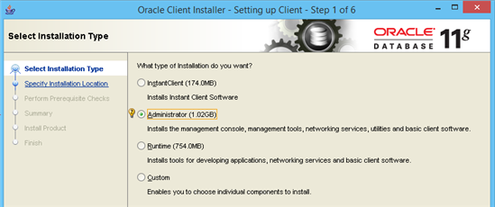

Make sure you have Oracle Client Administrator 32-bit installed on the machine. Oracle InstantClient will not do, it will give the same error as above.
You should be able to select Oracle Client Administrator at the first step of the installation when you launch Oracle Universal Installer.
