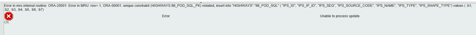

ORA-20001 unique constraint IM_POD_SQL_PK violated
Explanation

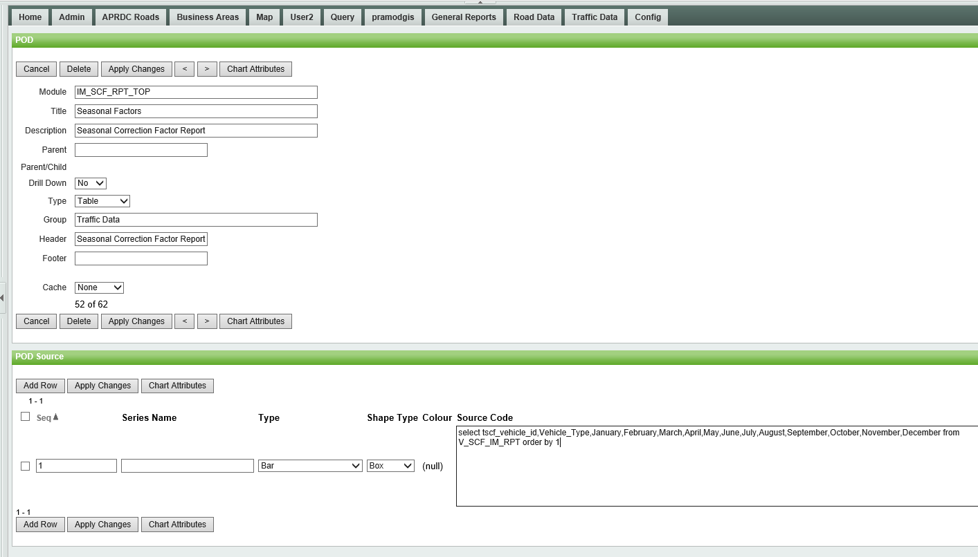

I am getting error "Error in mru internal routine: ORA-20001:" when trying to add SQL to the POD source.
How to Avoid
This error appears because the incorrect number is provided by IPS_ID_SEQ sequence. You need register it and recreate using scripts below. This script must be run by Highways owner.
insert into hig_sequence_associations (hsa_table_name, hsa_column_name, hsa_sequence_name)
values ('IM_POD_SQL', 'IPS_ID', 'IPS_ID_SEQ');
commit;
exec nm3ddl.rebuild_sequence('IPS_ID_SEQ');
