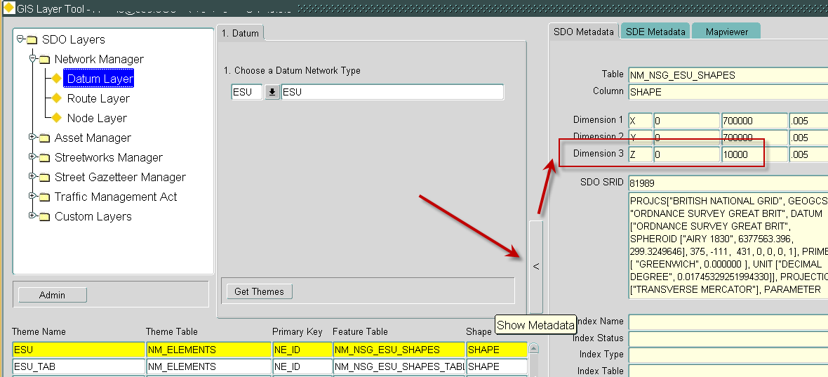

Explanation
Attempting to open Locator gives this error
How to Avoid
  1. Run script below as highways owner:
        SELECT NTH_THEME_ID, NTH_THEME_NAME, NTH_FEATURE_TABLE, NTH_FEATURE_SHAPE_COLUMN
          FROM NM_THEMES_ALL, NM_NW_THEMES
          WHERE NNTH_NTH_THEME_ID = NTH_THEME_ID
          AND NTH_BASE_TABLE_THEME IS NULL
          AND NOT EXISTS (SELECT 1 FROM NM_BASE_THEMES
                       WHERE NBTH_THEME_ID = NTH_THEME_ID);
  2.    in Exor go to Exor>GIS Data> GIS Layer Tool >Network Manager> Datum Layer, select themes provided in step1 and check SDO Metadata settings.  If theme's Dimension 3  is missing contact Bentley support and we will send you a script updating this field.
