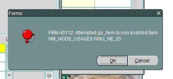

FRM-40112: Attempted go_item to non enabled item NM_NODE_USAGES:NNU_NE_ID
  Product(s): Exor Network Manager
  Version(s): 04.07.00.01
  Environment: N\A
  Area: Other
  Subarea: N\A
Problem Description

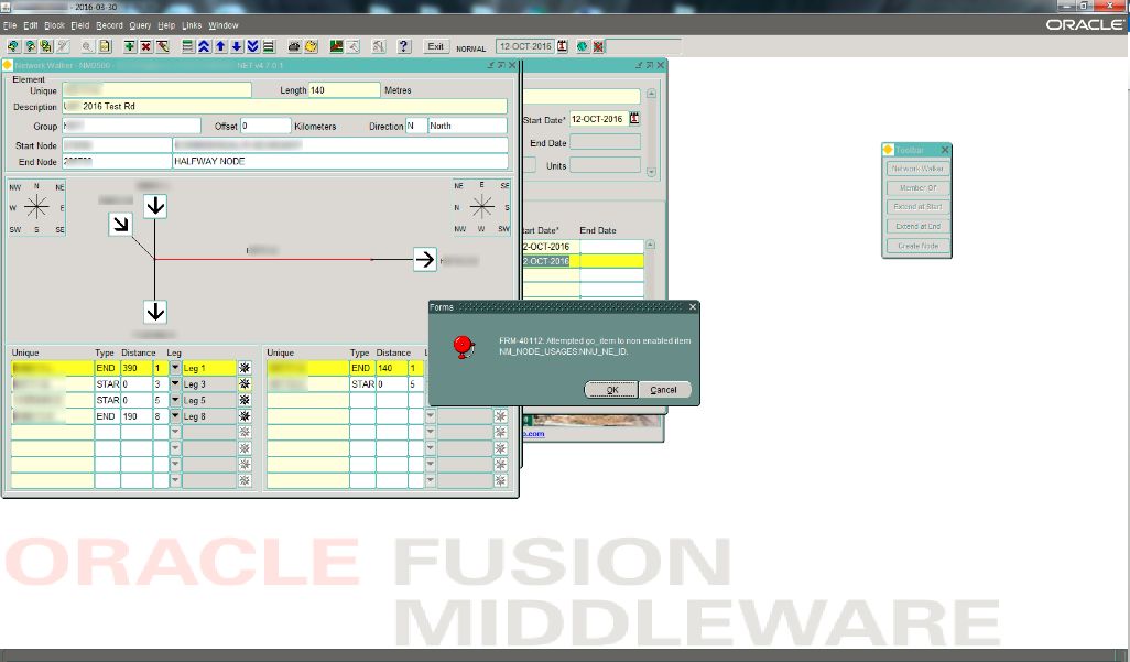

When traversing an existing route using ‘Network Walker’.
·        Query an existing element either directly in the ‘Network Walker’ form or from the ‘Elements’ form.
·        Click on the directional arrow to ‘walk’ along the route.
·        The error message shown below is displayed.
·        ‘OK’ or ‘Cancel’ is then clicked. The error message disappears and the reappears almost immediately.
·        ‘OK” or ‘Cancel’ is then clicked again. The error message disappears and the form returns the expected result (ie: progression to the next element)
·        Every subsequent click of a directional arrow in the form results in a repeat of the above result.
Steps to Resolve
This error message appears because FORMS_REJECT_GO_DISABLED_ITEM is not set. It must be set to DISABLED in default environment using Enterprise manager
