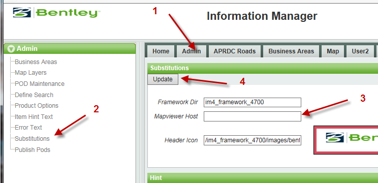

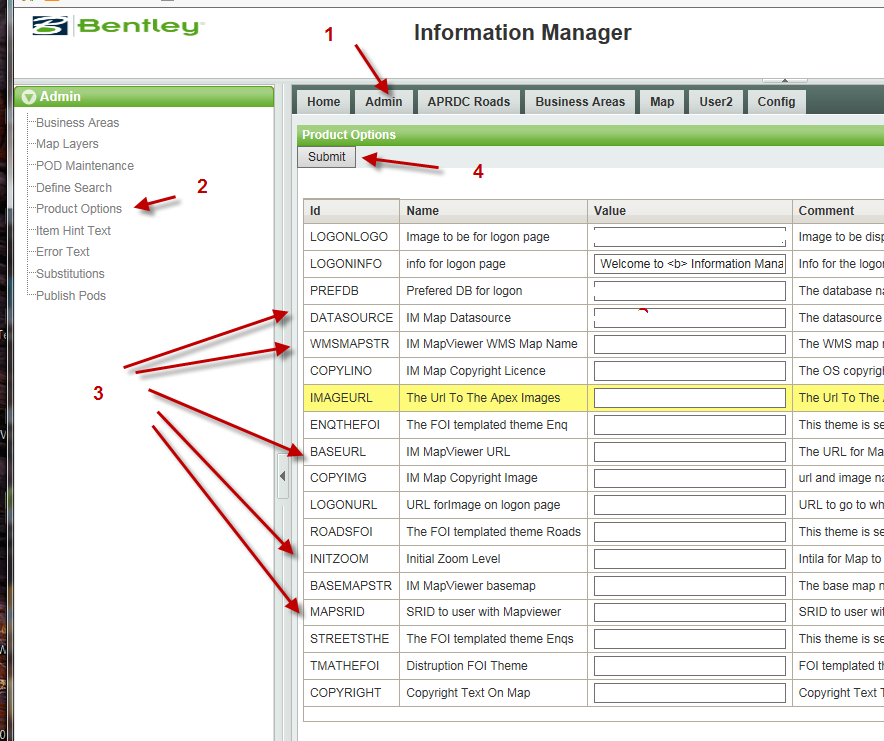

I have added Theme name in map config and submitted but still Map is not displayed. What else should I configure?
Cause: Map parameters are not set.
In Information manager click on Admin tab, select Product options, set values for following parameters DATASOURCE, WMSMAPSTR, BASEURL, INITZOOM, MAPSRID and click on Submit button.
Go to Substitutions, provide value for Mapviewer Host and click Update button.
