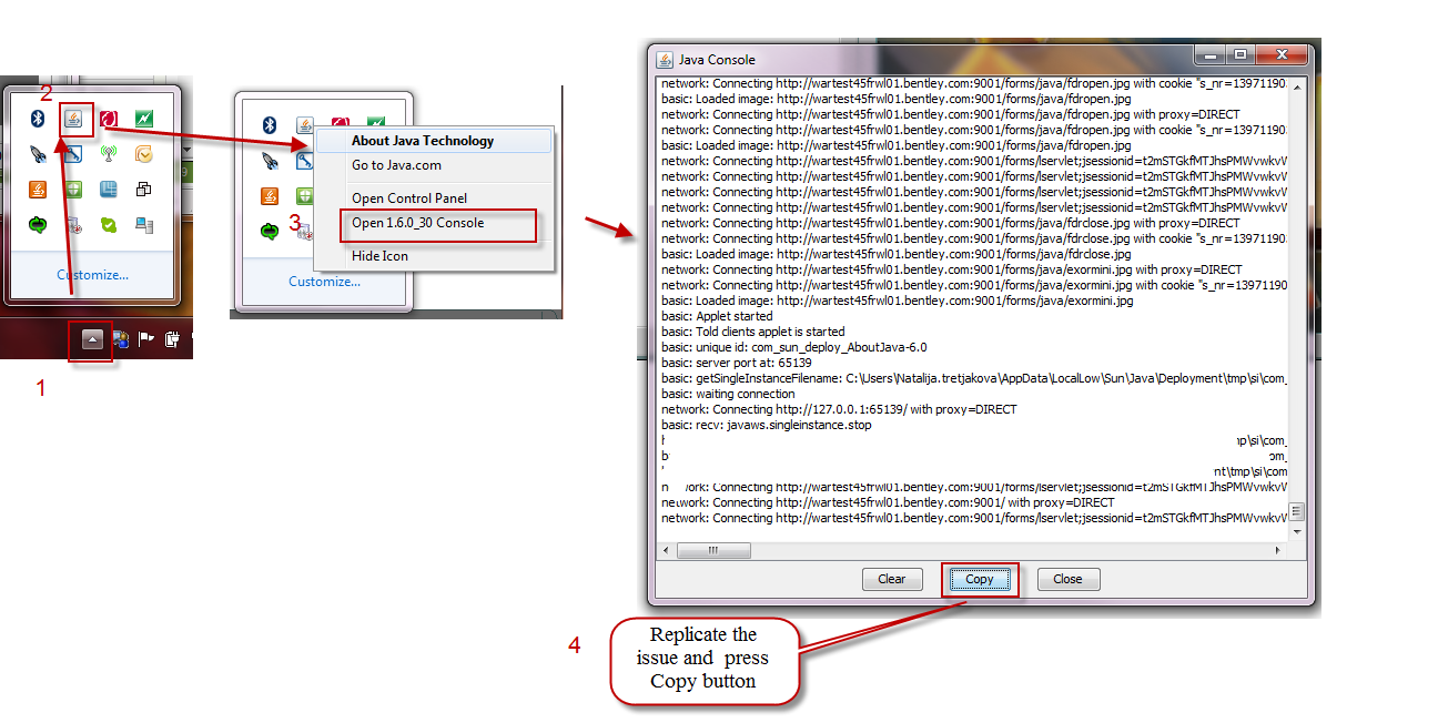

How to open Java console
1. Connect to the Highways by Exor and click on desktop right bottom corner java icon.  If the icon does not appear there, follow the link in the 'See Also' section below to enable it.
2. Right click on java icon and select “Open Console” from pop up box
3. Replicate the issue, press Copy button and paste content to any text file then send it to us.
How to enable the Java console: https://bentleysystems.service-now.com/community?id=kb_article_view&sysparm_article=KB0091580
