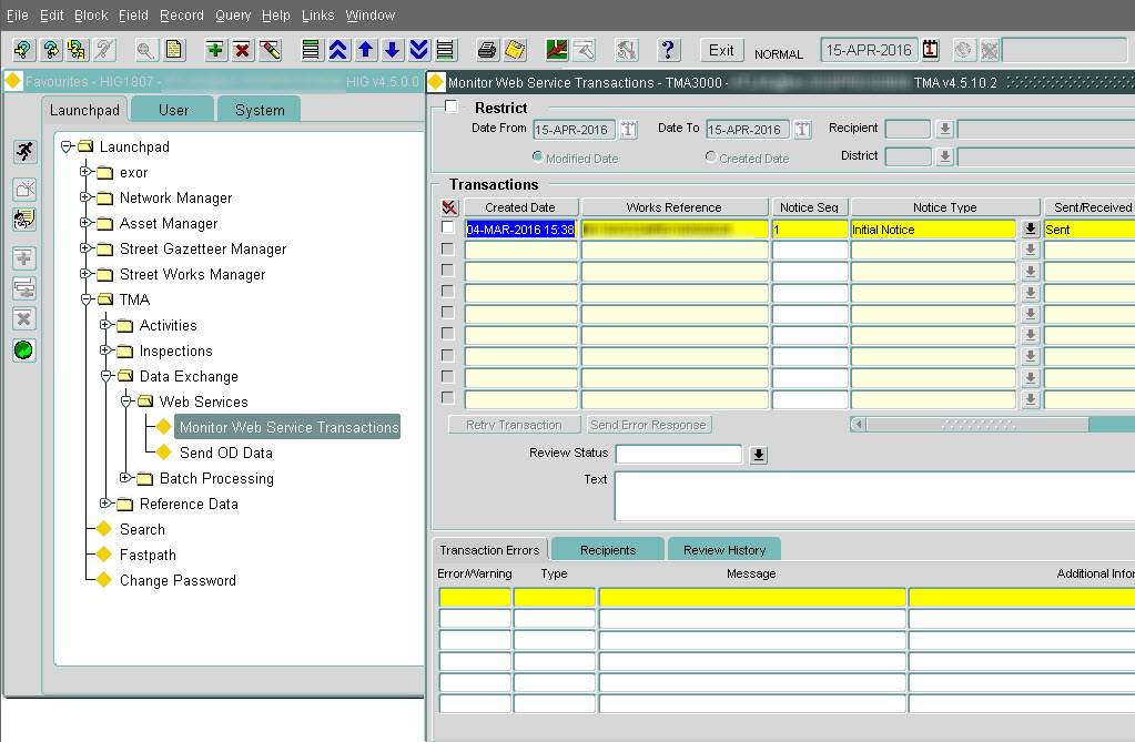

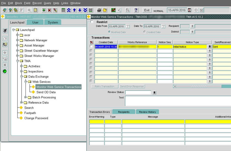

  1. Log into Highways by Exor, navigate to TMA / Web Services / Monitor Web Service Transactions (TMA3000) and query the relevant notice.

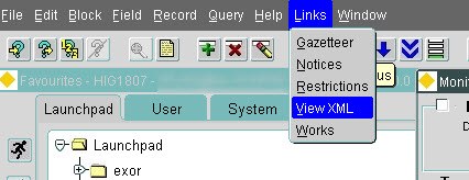

  2. From the menu select Links / View XML                                                                    .

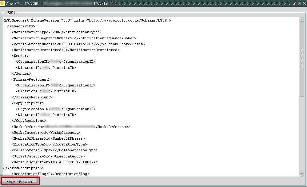

  3. In the window that pops up click the View In Browser button at the bottom.

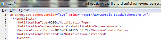

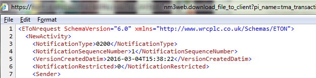

  4. This will bring up a new browser window with the XML in it.  If the XML appears as one long line of unformatted text, right-click in the middle of the browser window and select View Source from the menu.  This should give a window of formatted text similar to the screenshot below.
  5. Highlight and copy all the text in this window, paste it into a text editor like Notepad, or into Word, save it and send the text file or document in an email.
