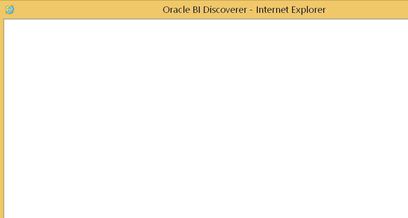

After entering connection details in Discoverer Plus it does not start. White screen appears. Please see a screenshot below

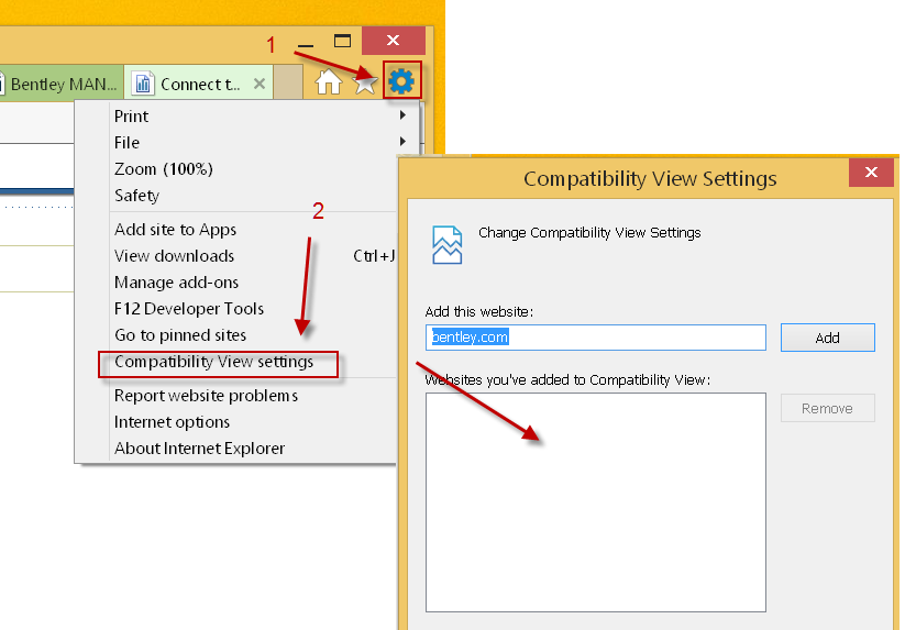

This happens if starting page was added to Compatibility View list.
In IE go Tools>Compatibility View Settings and delete the site from the list.
