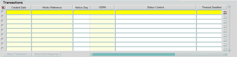

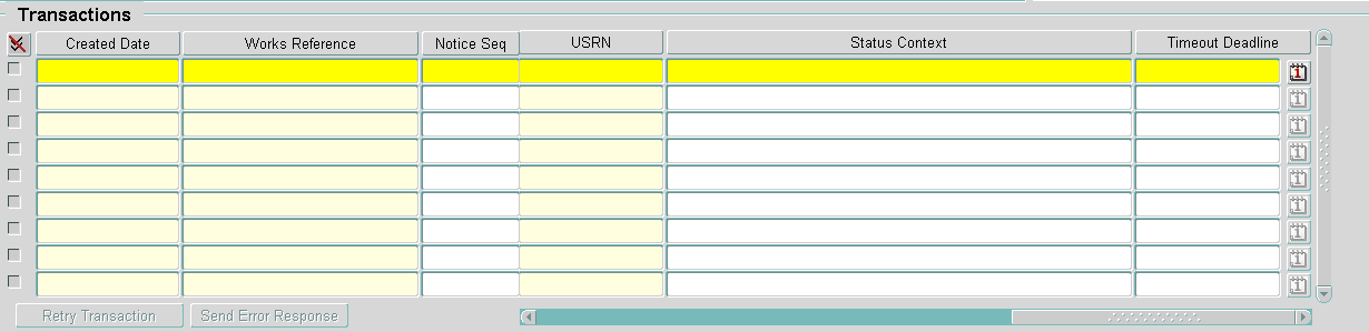

You can speed up the load of notices:
1. Query the notice in TMA3000
2. Horizontally scroll to the column called "Timeout Deadline" and click the calendar icon that is situated on the right.
3. Set current time and add few minutes in the future.
4. Save.
5. If you don't want to wait longer, run TMA Notice Received (it usually runs after 5-30 minutes) process so the notice will load.
