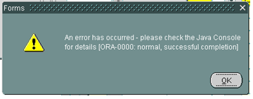

Exor Document Manager: Java error “An error has occurred – please check Java Console for details [ORA-0000: normal, successful completion]”  appears when trying to attach or open files in the Document Association form (DOC0120) .

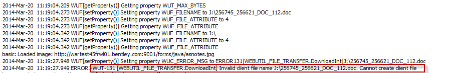

    If in Java console log there is a WUT-131 error message as in screenshot below then the directory (that was set in WORKFOLDER ) doesn’t exist on user OS. You need to create this directory or change WORKFOLDER to reference a different directory.

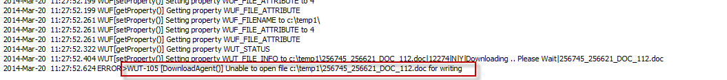

    If Java console log contains WUT-105 error message as in screenshot below then OS user doesn’t have Write permission on the directory (that was set in WORKFOLDER ).
