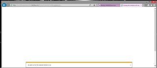

An add on for this website has failed to run
 Product(s):Exor
 Version(s):4.7.0.0
 Environment:N/A
 Area:Other
 Subarea:N/A
When running the forms application after installing JRE we get a message- An add on for this website failed to run
Open Internet Explorer-> Internet options-> Security-> Trusted sites-> Custom Level
Scroll the cursor till the ActiveX control and plug-ins-> enable the ActiveX scripting
