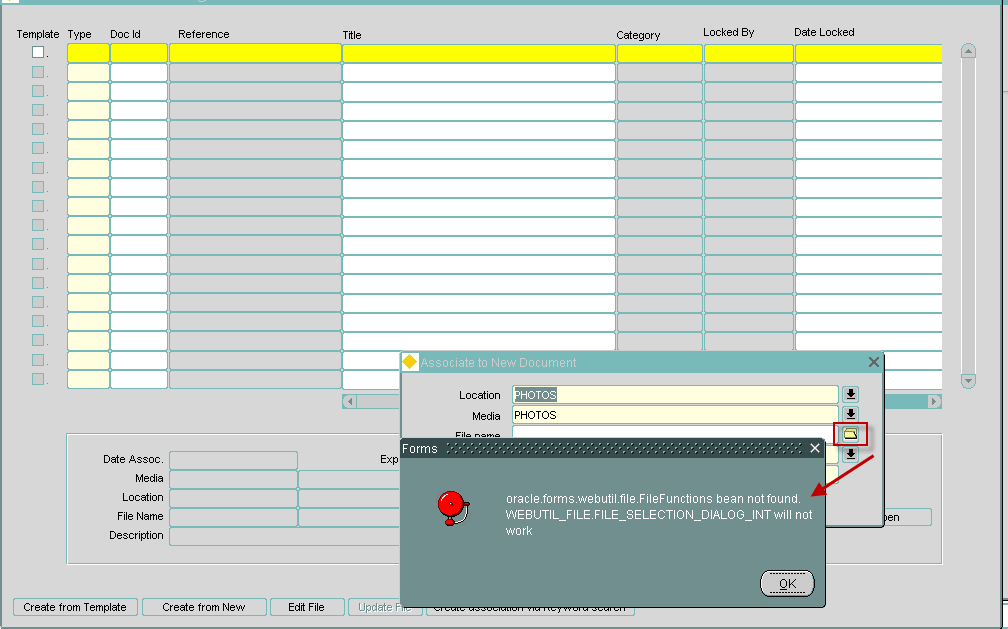

Error: Oracle.forms.webutil.file.FileFunctions bean not found.
  Product(s): Exor Enquiry Manager
  Version(s): 04.05.00.00
  Environment: N/A
  Area: Document Manager
  Subarea: N/A
Error or Warning Message
Explanation
A user can’t attach a new document and after pressing the folder button the error message
Oracle.forms.webutil.file.FileFunctions bean not found. WebUTIL_FILE.FILE_SECTION_DIALOG_INT will not work
appears in the Associate Documents form.

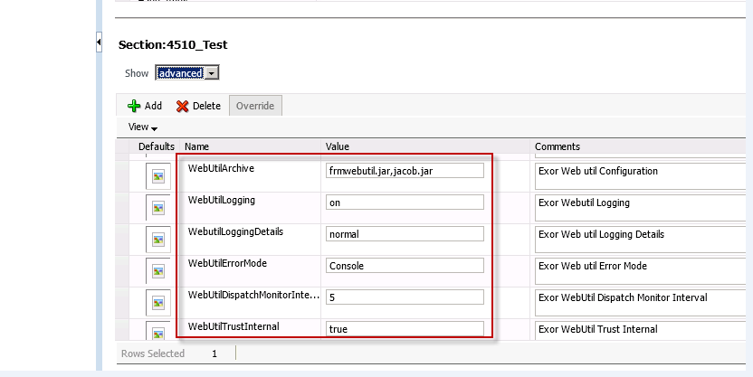

How to Avoid
This error message occurs because the WEBUTIL component wasn’t installed or configured. On the application server, please check
  1. frmwebutil.jar and jacob.jar are present in the folder < ORACLE_MIDDLEWARE_HOME>\forms\java
  2. jacob.dll was copied to folder < ORACLE_MIDDLEWARE_HOME\ >\forms\webutil
  3. the default section of formsweb.cfg must have options set as below:
  1. CLASSPATH (default.env) must contain the path for the Jacob.jar
More details can be found in the link below (p 14-22)
ALIM | Exor - Media Gallery - Product Installation and Upgrade Guide v4.5.0.0 - Communities
Note: This error message appears if on the user's PC  java version is 1.8 and on application server java 1.6. Please make sure that you are using same java version as the java version installed on the Application server.
