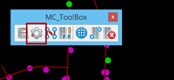

1. In MC ToolBox click on 'Settings and Preferences'

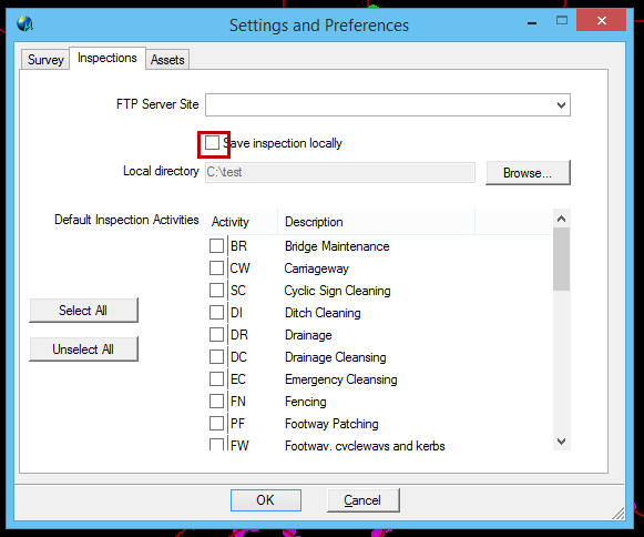

2. Under 'Inspections' tab un-check the 'Save inspection locally' box. The FTP Server Site drop-down list should become active (it is greyed-out before you un-check the box). The FTP Server Site should get updated after a connection is made to Exor or after you re-connect. It is supposed to show all the FTP connections available to be used for Inspection loading.

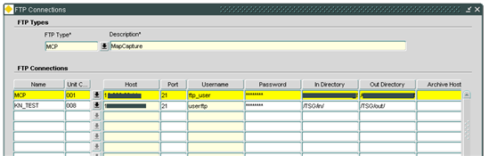

1. Make sure there is a FTP connection created in Exor 'FTP Connections form'. It must have name 'MCP'. If there is no connection created - please create one and test it to make sure it works.
2. Make sure that there is a process in Exor named 'Maintenance Inspection Loader' that is setup to use 'MCP' FTP connection as MapCapture performs such check.
