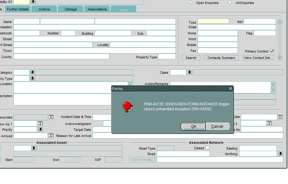

On opening PEM (DOC0150) form the error below appears.
FRM-40735: WHEN-NEW-FORM-INSTANCE trigger raised unhandled exception ORA-06502
Explanation

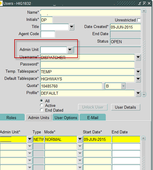

This happens because Admin Unit is not specified for the user.
How to Avoid
  1. Connect as Highways user
  2. In Users form (HIG1832)  select the user.
  3. and set value for Admin Unit field.
