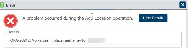

There are 2 symptoms of this issue:
There were network edits happening that week, and one of the impacted network sections had been replaced. Something hadn't gone quite right with one of the replacing sections, and it needed rescaling in AWLRS. Once it had been rescaled the event was fine.
To identify the affected section I created a new event on the test system that is a copy of production and added each section from the original event one by one and eventually I saw the ORA-20212 error.
