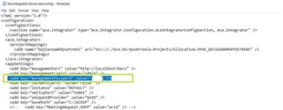

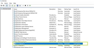

How to correctly change the BECS password:
1. Stop BECS integrator 5 service
2. Change password for user “admin” in BECS VA
3. Change this password in Ace.Integrator.Server.exe.config
on path C:\Program Files (x86)\Bentley Enterprise Connection Services\BECS Integrator 5\
