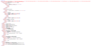

2.3 Service Input
BECS Integration Project called by General BECS SOAP Service is adapted exactly for requirements of this project. So please use following XML (sample data included!):
2.3.1 ​​​​​​Real Input XML in file
UpdatedInput.zip (clicking the link automatically downloads the file)

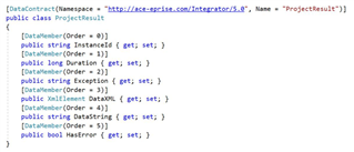

​​​​​​​2.3.3 Returned structure from General BECS SOAP Service
General BECS SOAP Service is designed to return important information of the running project as well as BECS Integration Project specific values in a form of XML and STRING. General return structure is class “ProjectResult” as follows:
2.3.3.1 ​​​​​​​​​​​​​​XML format output
is always formatted with XML handling of possible special characters as follows:
​​​​​​​2.3.3.1.1 Special characters replacement table
2.3.3.2 STRING format output
is always formatted exactly same as are retrieved from destination Bentley application (consist of special characters if obtained).

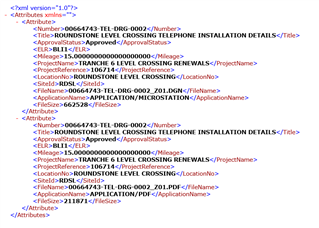

​​​​​​​​​​​​​​2.3.3.3 Returned XML structure sample
General BECS SOAP Service returns following structure as a sample of testing call:
2.3.3.3.1 Returned sample in File:
OutputSample.zip (clicking the link automatically downloads the file)
