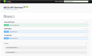

2.2 General BECS REST API Service Swagger
Service swagger is on following URL:
Swagger UI (bentley.com)
Please be aware, that Service EndPoint depends on machine where the service is installed, so it needs to be changed to proper architecture every time!

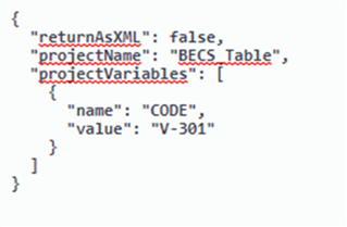

2.3 Service Input
BECS Integration Project named “BECS_Table” and called by General BECS REST API Service is adapted to read FLOC data from SAP for selected Code. In this sample implementation is following input .json used:

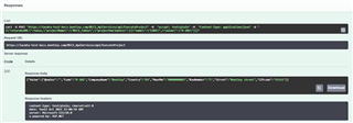

2.3.1 ​​​​​​Returned structure from General BECS SOAP Service
General BECS REST API Service is designed to return important information of the executed BECS Integration Project. For our sample project was returned:
