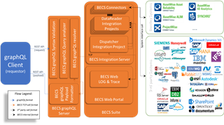

1.2.2 General architecture of BECS graphQL Service
In following picture, you can see the global architecture of BECS graphQL Service and its cooperation with standard BECS IP. Schema shows standard flow for graphQL requestor:
1​​​​​​​.2.2.1 Execution steps for standard graphQL interaction
Following picture in previous chapter the execution flows can be described:
      1. graphQL caller is querying BECS graphQL server with well formatted graphQL query
      2. ------------------------------------ BECS graphQL Server --------------------------------------------------------------
      3. BECS graphQL server is starting to execute external query in following steps:
        1. Validation of graphQL Query syntax – in this step is validated not only graphQL syntax, but also the implemented directives (BECS graphQL server has, of course, not adapted whole graphQL syntax – see later)
      4. Successfully validated graphQL request is analyzed to retrieve:
        1. List of data tables required to update from external system
        2. Query to apply on updated Data Tables
      5. Analyzed output is then encapsulated to proper BECS TCP request and BECS Server is called
      6. -----------------------------------BECS Integration Service-----------------------------------------------------------
      7. BECS Received call into “Dispatcher Integration Project”
        1. This project will resolve what are the names of BECS DataReader integration projects assigned to Data Tables requested
        2. Dispatcher is execution all investigated BECS DataReader Integration Projects
          1. Each project is using related BECS Connectors to communicate with external systems
        3. Execution is returned to Dispatcher Integration Project to package all retrieved data from DataReader projects into one payload
      8. ----------------------------------BECS graphQL Server-----------------------------------------------------------------
      9. BECS graphQL Payload Formatter generate output in requested format (XML/json)
      10. Data are returned to called (graphQL Client)

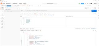

1.2.3.1 End-point description
Because graphQL is json-request syntax, we will use for all demonstrations a standard POSTMAN software (https://www.postman.com/downloads/ ):
To minimize duplicity in presenting samples will be always used endpoint:
https://uks-qa-becs.bentley.com/BECS.Odata.Translator/api/graphql

Request:
Response (json):

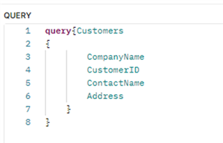

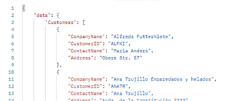

1.2.3.4.1 Simple Data Request
As defined in graphQL standards also BECS graphQL Service returned data via simple query request:
Please be aware, that Service EndPoint depends on machine where the service is installed, so it needs to be changed to proper architecture every time!
Request:
Response:

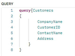

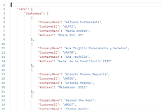

1.2.3.4.2 Field selection
For retrieving only selected fields can be used list of requested columns in original query request.
Request:
query{Customers
{CompanyName
CustomerID
ContactName
Address
City
Phone
Fax}}​​​​​​​​​​​​​​
Response:

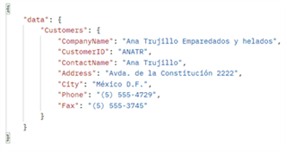

1.2.3.4.3 Data filtering Request
As defined in graphQL standards also BECS graphQL Service supports filtering by any column from table.
By placing filtering condition in brackets after the data object name, BECS graphQL Service will return filtered data.
Request:
query{Customers (where: {CustomerID: {eq: "ANATR"}})
{CompanyName
CustomerID
ContactName
Address
City
Phone
Fax}}
Response:
