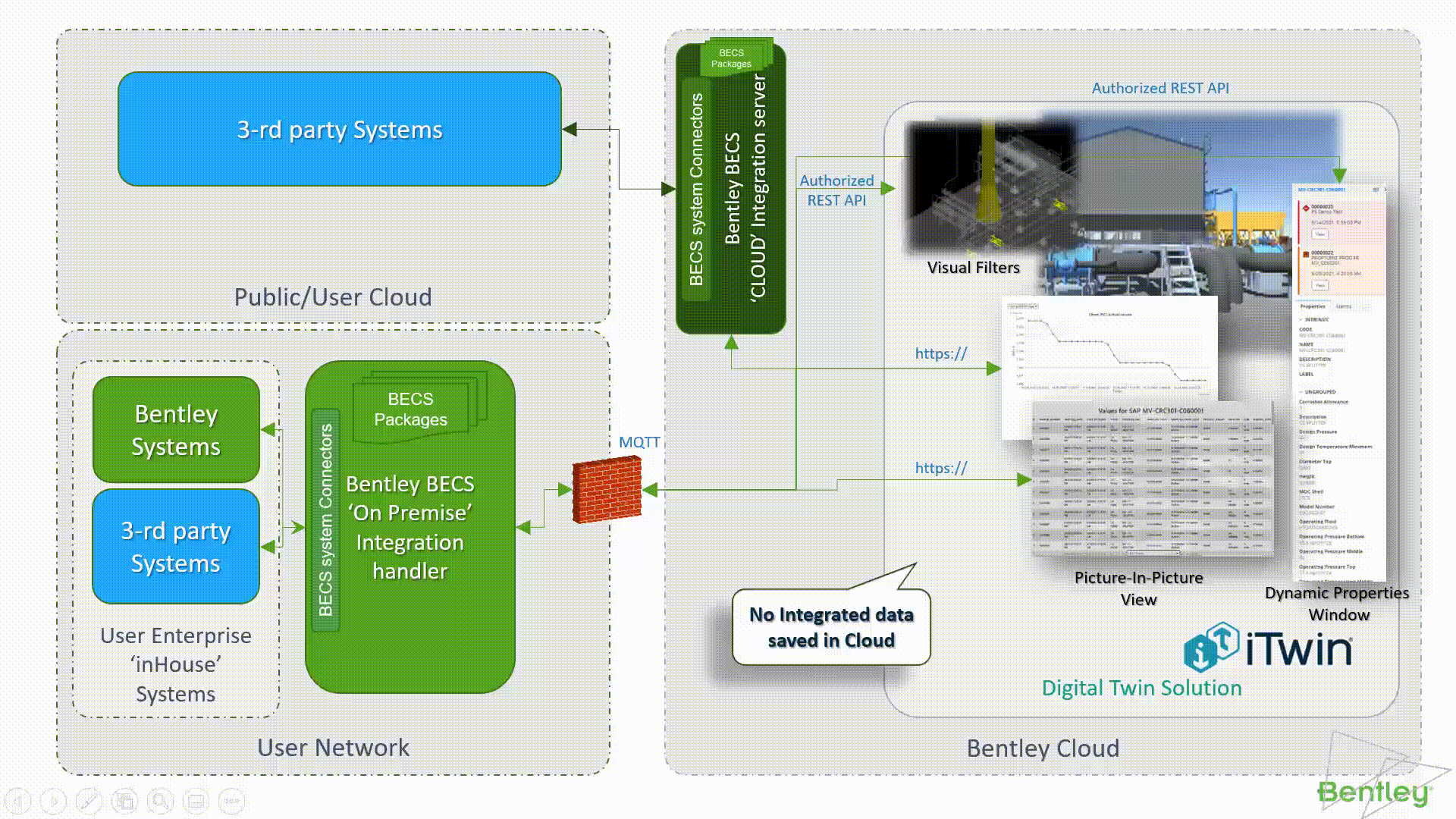

BECS Integration Server allows to run the BECS dataReading Projects, independently if your enterprise systems are in a public/user cloud, or if they are inside a secure internal network not exposed to the internet:
What do you need to install?
In the table below you can see the installation requirements for execution of BECS dataReading projects depending on usage in cloud or on premise environment:
  On Premise environment Cloud (Bentley) environment
BECS Integration Server BECS installation required - follow the BECS Installation Guide No installation of BECS required
BDPI BECS installation required - ask BECS Team for more info No installation of BDPI required
dataReading project Upload of the dataReading Project in BDPI required Upload of the dataReading Project in BDPI required

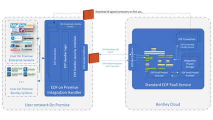

BECS On Premise Handler
BECS On Premise Handler is a small piece of a software you can install into your internal infrastructure. On Premise Handler do the interaction between your enterprise systems right in your network and the communication with BECS cloud is done by the secure MQTT protocol. MQTT allows safe communication with no need of exposing any endpoints or opening any ports from your local network.
