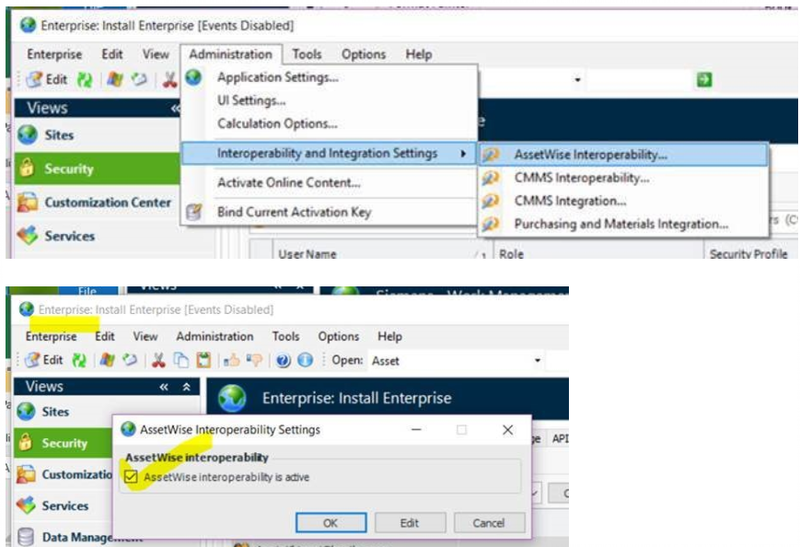

Enterprise configuration
Log in to APM, and launch the Enterprise object. In Enterprise’s Administration menu, choose “Interoperability and Integration Settings >” and then “AssetWise Interoperability…”
Then, in the resulting pop-up dialog, ensure that you check “AssetWise interoperability is active”.
Be sure to click OK to save your changes.
