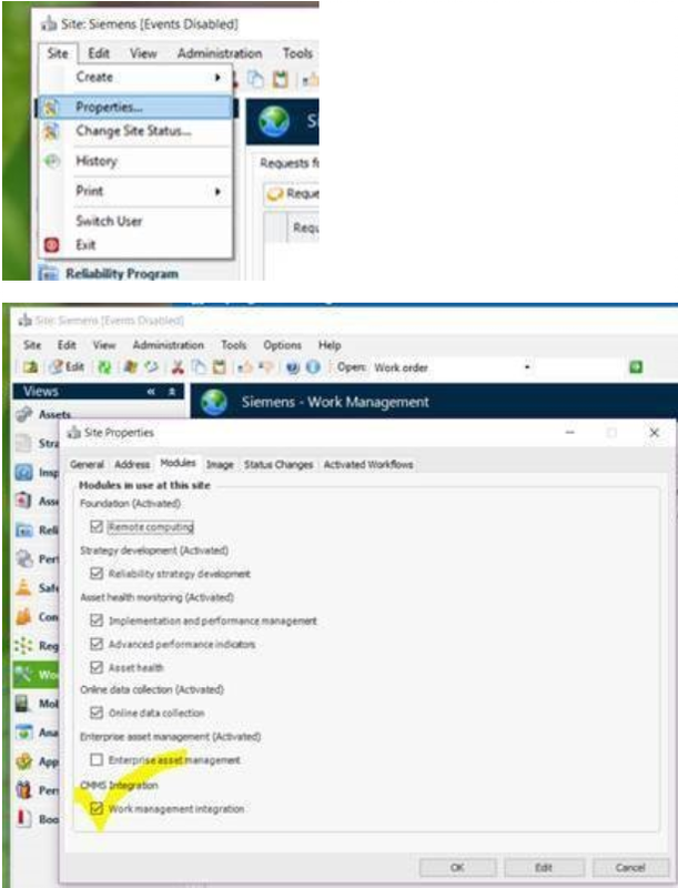

You must be logged in as an APM user who has authority to modify Site.
  1. The Site’s properties must activate “Work Management Integration.”
Use the Site menu to open the Properties dialog.
Within this dialog, go to the Modules tab, and ensure that Work Management Integration is checked for ‘yes’.  If you need to change this setting, you may need first to click Edit.
Click OK to save your changes.

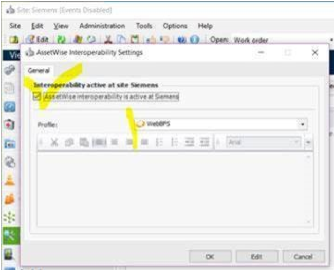

Now navigate to Site’s Administration menu, and choose Interoperability and Integration settings | APM AssetWise Interoperability.
The AssetWise Interoperability Settings dialog will be displayed.  On this dialog,
2) Make sure that Interoperability is checked as active.
3) Select the appropriate integration profile, such as shown here.
