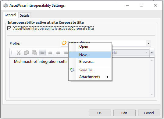

To create a profile, while in the AssetWise Interoperability Settings dialog shown in Site Configuration, navigate to the Profile drop-down field, invoke the right-click context menu, and choose 'New'.
Right click and select New...
That will display the dialog shown below.

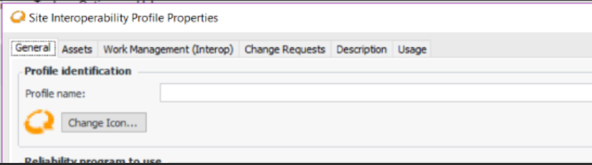

Site Interoperability Profile Properties
General tab
The General tab allows you to name the profile, and specify which systems are the system of record for reliability, work documents, and work management history.

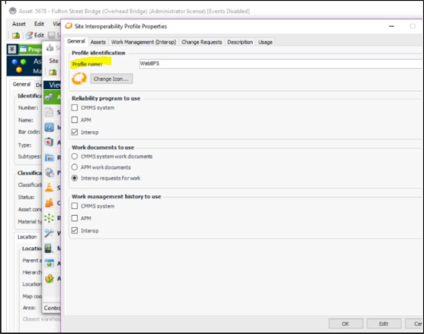

Profile identification
As a rule, you want the Profile Name to identify the CMMS system unambiguously.  This can include a number of aspects:
Examples are SAP_Production, Oracle_Dev, and WebBFS_SanGabriel_QA.  In this example, the Profile name is WebBFS.
System usage
Profile identification - Profile name

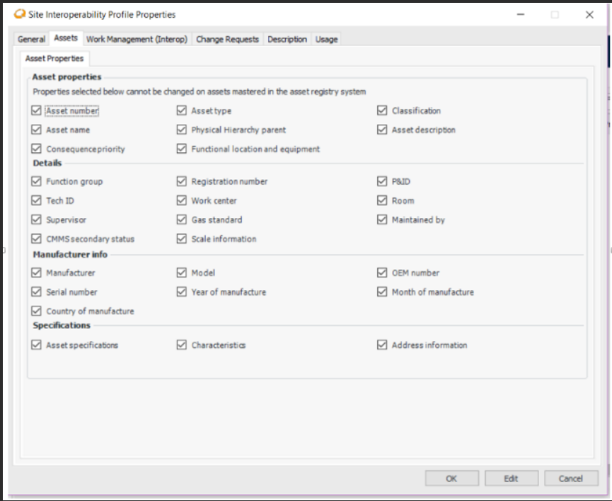

Assets tab
The Assets tab indicates which fields will be non-editable even when the APM asset is checked out for editing.
For a customary APM-and-CMMS integration, all fields should be checked.
Assets tab with all fields checked

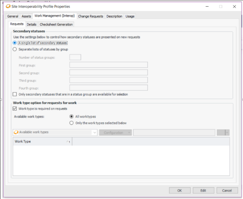

Work management (Interop) tab
On the Interop tab, choose the settings appropriate for the work management features. This specifies the usage of Secondary statuses and Work types.
 Work Management

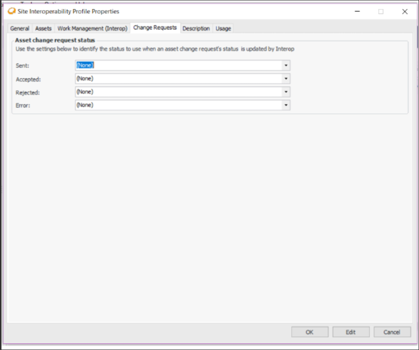

Change requests tab
On the Change requests tab, the settings relate to default asset status values in standard scenarios. If using the asset change request functionality, select a status for each.
