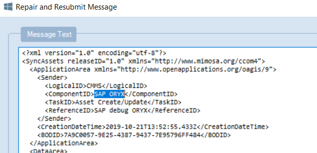

To narrow down to messages only from that environment, specify the ComponentID in the BOD's Application area.
Use the Service Bus Explorer to find the exact ComponentID used in that environment.
Find ComponentID via Service Bus Explorer

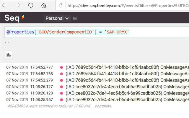

The syntax for adding this filter is:
@Properties['BOD/SenderComponentID'] = 'SAP ORYX'
