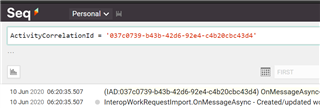

NOTE: if you want to specify a filter you add the -f "" part in green.  This can be the filter that you use on a webpage to filter results.
If you aren't using a filter from the webpage, remove the -f part.

With filter:
seqcli search --json -f "ActivityCorrelationId = '037c0739-b43b-42d6-92e4-c4b20cbc43d4'" --count=1000000 > c:\logs.json
