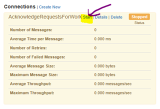

Look at the Connections section (scroll if you need to) and find the connection at issue here.
For example, here is the connection for AcknowledgeRequestsForWork inbound to APM.
Stop the connections for SyncWorkRequests, SyncSolutionPackages, etc.
Click stop once on each: it doesn't respond quickly even though it is really working
After a moment, refresh the listing to confirm that each is stopped
Incoming messages will pile up in the queues now.
Once finished, start the connection(s) again..
