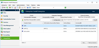

Look up the InfoSource
When setting up Interop topics, you must provide a unique value for the APM InfoSource UUID and ShortName, for the messages outbound from AssetWise APM.
Inside APM's Enterprise object, look up the AssetWise Interoperability System that represents APM.
