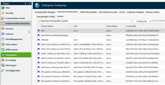

In the architecture sense, there should be an InfoSource representing the APM system and a different InfoSource for the CMMS system.  In future releases of APM and Interop, we will support integration of multiple CMMS with the APM system.  In that case, these separate CMMS must each have their own InfoSource UUID and ShortName.

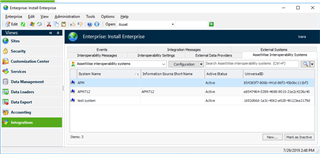

Inside APM's Enterprise object, create an AssetWise Interoperability System to represent APM, and a second one to represent the CMMS.  Name each of them to indicate whether this is development, production, etc.
TIP: Modify the configuration to display the UUID (known as the UniversalID).
NOTE: This tab has been moved in later versions of APM ( It is now under Integrations -> AssetWise Interoperability -> Systems )
