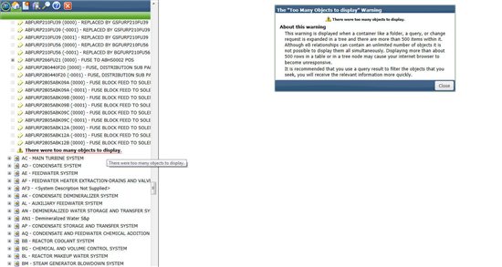

Not all Tags listed under System VI
 Product(s):eB Nuclear Engineering Design
 Version(s):15.5.1
 Environment: Usability and Human Performance
 Area: Paging
 Subarea: N/A
 Original Author:Deepti Patil, Bentley Technical Support Group
Problem Description
The Plant Assembly Navigator only lists numerically the first 500 Tags under each System VI and does not obey the chosen 'page' number.  Systems MUST list ALL associated Tags. Same behavior in eB Web.
Reason
While 'Paging' was introduced for Hierachical navigator displays
Steps to Resolve
Option : Apply Hotfix HF00341
  1.  Issue was fixed verified and tested on both SQL/Oracle DataBase with Hotfix00341.
