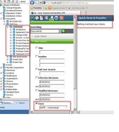

Problem Description:
Searching by a parent class in Extended Searches is returning zero hits. This is a regression.
In previous versions, you can enter a parent class in the Extended search and the results would return documents for all subclasses. In eB Web 15.4.1.325 this is  not working. Nothing is returned.
Reason:
Known issue for version 15.4.1.
Resolution:
Issue is fixed and verified in HF00331.
