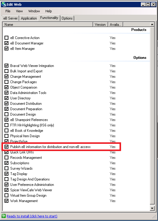

The Publisher plugin is installed when selecting the ‘Publish eB information for distribution and non-eB access’ when creating your web site, as shown below.
With the Publisher Plugin installed, you can create, modify, delete and/or publish packages of eB objects. Publisher
packages include all contents: object instance data, hierarchies, and the files contained within documents. A package may be formatted as html, chm (Microsoft help file,) or xml. Thus they are inherently suitable for distribution to  non-users of eB and entities outside your enterprise.

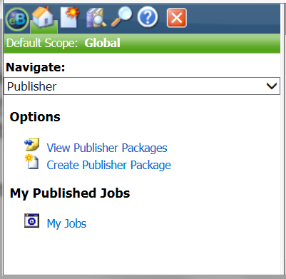

A publisher drop down in the navigate tab:

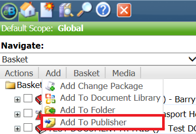

And from the basket:
