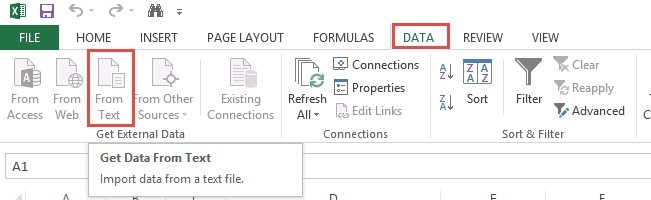

3. Run Excel
4. Go to the Data tab and click the “From Text” button
5. Browse to the download folder where the CSV file was saved, select the file and then click Import

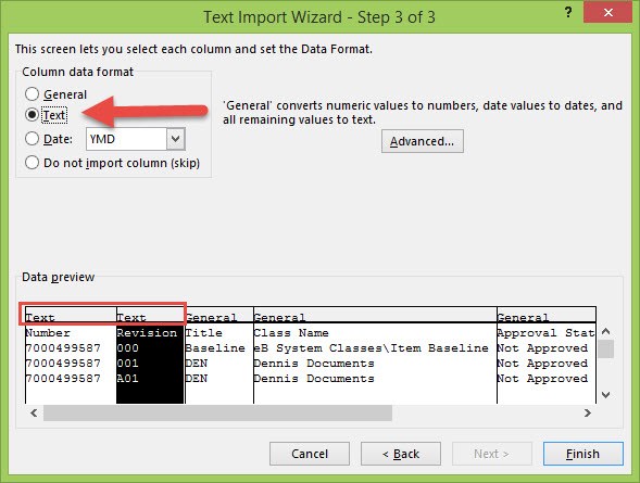

6. In the Text Import Wizard - Step 1 of 3 window, click Next
7. In the Text Import Wizard - Step 2 of 3 window, ckeck the box next to "Comma"
8. In the Text Import Wizard - Step 3 of 3 window, click the columns in concern and select Text
9. Click Finish
10. Now the data should display in excel with all the leading zeros retained.
