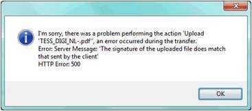

In eB version 15.5.1 HF00341 Error message is received when uploading file (I’m sorry there was a problem performing the action ‘Upload ‘FILE NAME’’, an error occurred during th transfer. Error: Server Message: ‘The  signature of the uploaded file does match that sent by the client’ HTP Error:500’)
Reason
BUG in ActiveX  which is found in HF00341.

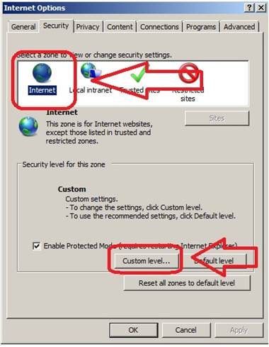

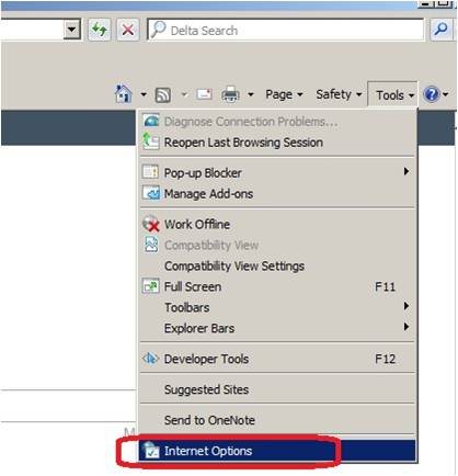

    1.  In your Internet Explorer window From Tools select Internet options.
    2.  Next select in ‘Security’ tab select the ‘Internet’ option and click on the ‘Custom level’ button.

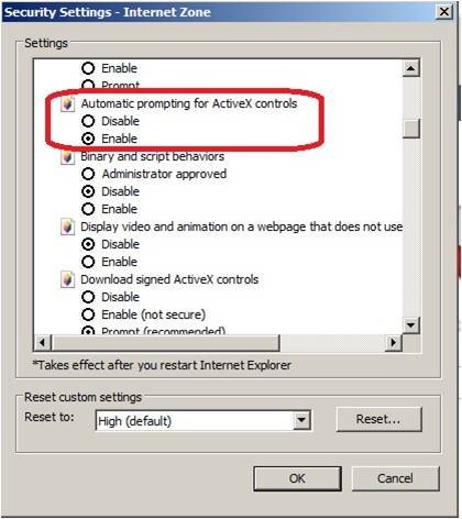

    3. Next for ‘Automatic prompting for ActiveX controls select ‘Enable’ as shown below.

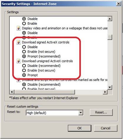

    4. Next for ‘Download signed ActiveX controls’ and ‘Download unsigned ActiveX controls’ select ‘Prompt’ option.
    5. Click ‘Ok’ and save the settings.
