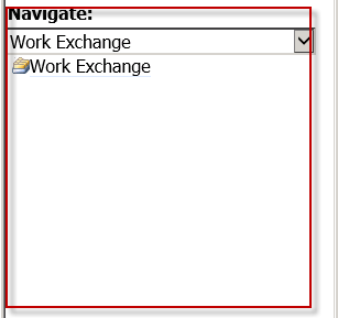

After migration to eB version 16 some functionalities does not work properly. For example Work Exchange in Navigation pane does not load content

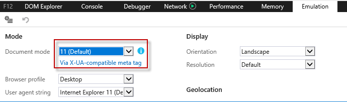

How To Identify
Connect to eB WEB using Internet Explorer (you must be connected to eB site as this option might change depending on webpage you have open).
Open Developer Tools. Developer Tools can be found under Internet Explorer Tools or can be called by pressing Shortcut key F12
Developer Tools will load at the bottom of the browser.
Navigate to Emulation tab and inspect  Document Mode property
If it's set anything else than 11 or Edge proceed to next step, otherwise your issue not related to Document Mode.

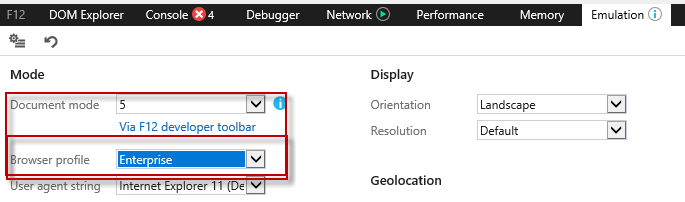

  1. Setting pushed by internal IT using Enterprise Mode.
    If in Developer Tools you do see Browser Profile : Enterprise, it means that this setting is pushed by internal IT department. You will have to contact your IT to fix this issue.

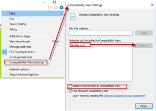

  2. Setting overridden by Compatibility View Setting.
    If in Developer Tools you do see Browser Profile: Desktop, but Document Mode:7 , then this setting is overridden locally by Compatibility View Settings.
    This can be fixed locally by navigating to Internet Explorer Tools>Compatibility View Settings and by deleting eB website address from list. If eB is intranet site you might need to deselect option 'Display intranet sites in Compatibility View'
