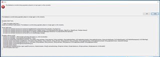

User is trying to log in to Director and getting this error.
Error:
The database is currently being upgraded, please try to login again in a few moments.
Root Cause:
This leaves the database upgrade in middle and causes error while logging in.
  1. Go to SQL Server Management Studio, Go to the databases make a new query for the database you are not able to log in
  2. Run this query: “Select * From db_packages
  3. You will get the following SQL
         4.The status codes are as follows U-Upgrading, I-Invalid, V- Valid. This creates the issue while logging in into Director.
         5.Run the another query to change this status to ‘V’. Update db_packages Set status='V'
This should resolve the issue.
