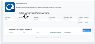

  1. Go To: https://connect.bentley.com/
  2. Login with IMS Credentials of Login Screen.
      3.Go to “My Services” Section end of the page and click on “Software Downloads”.
      4.Select Product Line as “Infrastructure Asset Management” and Brand as “AssetWise” and Click on Apply.
       5.Select Product which you want to download from results list, ex. AssetWise CDE (English) and click on “Get Software”.
       6.It will redirect to Product Info page and there you can Download the product.
If you do not have permissions to download software, you will have to contact your site administrator to be assigned the correct permissions.
