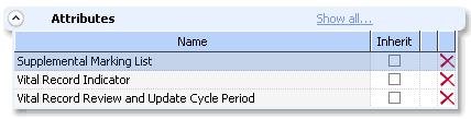

Attributes on the File Plan component would follow the data scheme defined by the File Plan [component] Class. For example DoD5015 calls for the following attributes on a File Plan Components:

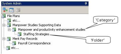

Once the File Plan [component] classes and attribute definition is configured; we embark on defining the actual File Plan schema. In this example ‘Staffing Strategies’ is a File Plan component of type ‘Folder’ and will therefore have attribute instance data of [say] ‘Vital Record Indicator’ stored against it.
