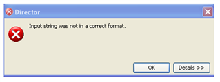

User is getting error saying "Input string was not in a correct format" while creating object / entering details while creating objects / Saving any object
Input string was not in a correct format.

Solution :
Changed the Regional settings to English. Logged on to eB Director again
